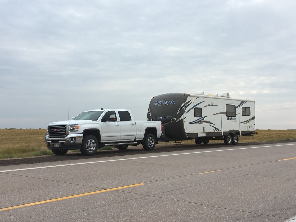

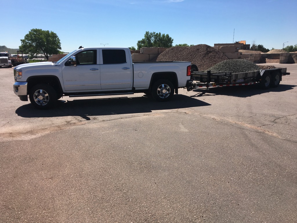

Weight distribution for you is pointless at this point. Sway control is another thing.
I don't use a WDH with my Jeep and 16' equipment flatbed (trailer empty 2900 lbs and Jeep is 5200 lbs) and it pulls great. Now if I put landscaping materials and have the trailer close to 14k lbs, I use the WDH.
Now with my camper, 28' TT (I can't wait to go back to GN trailers) I use my LDH religiously for sway control. Recently I took a little 3000 mile trip in high winds and the hitch did its job in the sway department, that is for sure. I still wore the crap out of the rear axle tires on the trailer though. Oh well, they had 20k miles on them and 4 years old. Time to swap out anyway.
