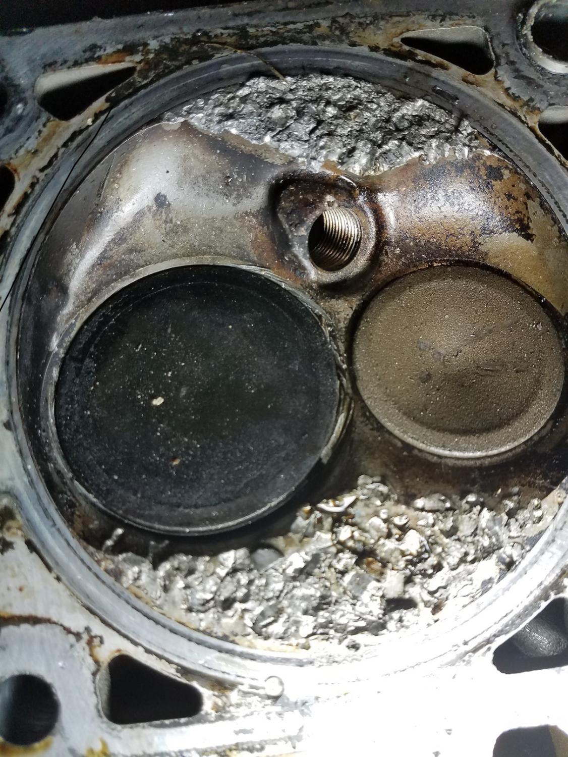

So I got the motor out and took the head off and this is what I found... What I cant figure out is what the heck could have caused this. There is a large piece of the piston missing all the way down to the piston ring and as you can see both the head and piston is beat to hell and back. The top of the valve skirt is also broken which I dint know is this was a cause of effect.
I guess the question now is, what the are the chances of something in the bottom being damaged due to this. Like a rod or bearings or crank... Guess I will fine out tomorrow when I pull the oil pan but I am going to keep my fingers crossed that I will get some kind of luck and get away with a new head, piston and cylinder sleeve. Advise from here anyone?
