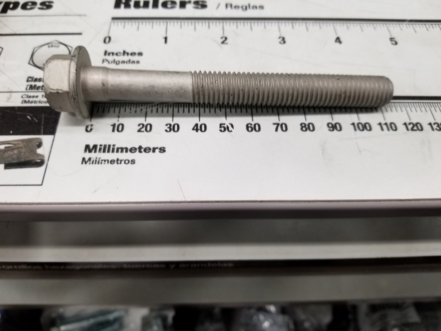

I was wondering more about the bolts, the long bolt that goes through the tow hooks, ( the one you had to cut to remove the hooks) how’d you get that bad boy reinstalled?
Just turn it around  and come in the other way.   I believe from the factory the bolt head is facing inboard.  Just turn the bolt and come in from the outboard side and put the nut on the inboard side.

Do you happen to know what the thread pitch is?  18x1.5?
@ChevyRoofer and @Waterfowler41
I'll be sending you your refund tonight WaterFowler so that you don't have to spend money on me shipping them to you unless you'd still like that. That is up to you.
The bolts you're looking for are class 10.9 bolts.
M12x1.75.
2x 110mm bolts
2x 50mm bolts
2x m12x1.75 nuts.
You can find the bolts here.
https://www.mcmaster.com/#standard-hex-head-screws/=1a6s92v
Either a 45 or 50 will work. Hell a 40mm will work as well. The 100 should work as well instead of a 110mm.
Trying to thread the nut however seems like its some sort of locknut. It doesn't have any insert though but I would suggest you get a locknut and a washer or just the flanged nut and some threadlocker.
