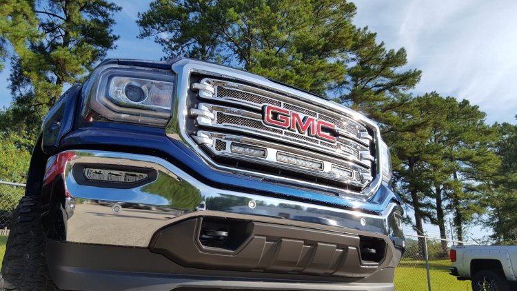

Here’s my ‘17 with active shutters.
Tri-row LED light bar
Looks great!
Did you remove the active shutters? or were you able to fit the led bar with them?
Do you have any pictures how you mounted it?
Looks great ??
