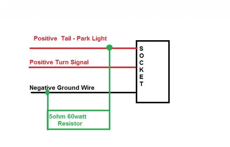

The LED tail light bulbs are probably causing the fast blinker issue. They don't pull the amperage that the incandescent bulbs do. People have wired in resistors to make them blink properly. Also the side marker lights sometimes use as a ground the turn signal circuit. One wire is hot with the parking/tail light circuit and the other wire is getting it's ground from the filaments in the turn signal bulbs.  Then when the turn signals are flashing that's why you get the alternate flash from the marker lights when the headlights are on, because both wires are hot when the signal is flashing. When the headlights are off the side markers blink with the signals because they are using the filaments in the parking/tail light for ground. It's similar to a trailer without a proper ground and everything blinks opposite. Sorry about the long post. Not very gifted when it comes to writing. Maybe try putting incandesants back and see if that resolves both issues, if it does and you still want the LED's wire in a resistor.
The LED's are the problem. You need 6 ohm 5Watt Load Resistors.They are around 8$ on amazon. http://amzn.to/2iPT1Jh
Don't laugh at my 6year old drawing. Just trying to help! lol.
