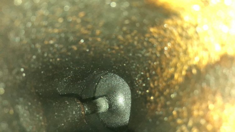

Changed injector and still misfire on cylinder 4.  So coil, plug wire, plug, and injector are fine. Why is the cylinder still misfiring? Valves  looked to be seated and had some carbon build up but not enough to be a problem I think.
