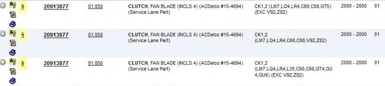

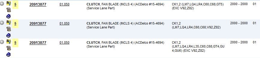

Also -  does anyone have the correct OEM part number?  seems there are a bunch of "heavy" duty, "severe" duty, choices. I just want the normal OEM - truck is basic 5.3L Silverado.

The part number is 20913877
