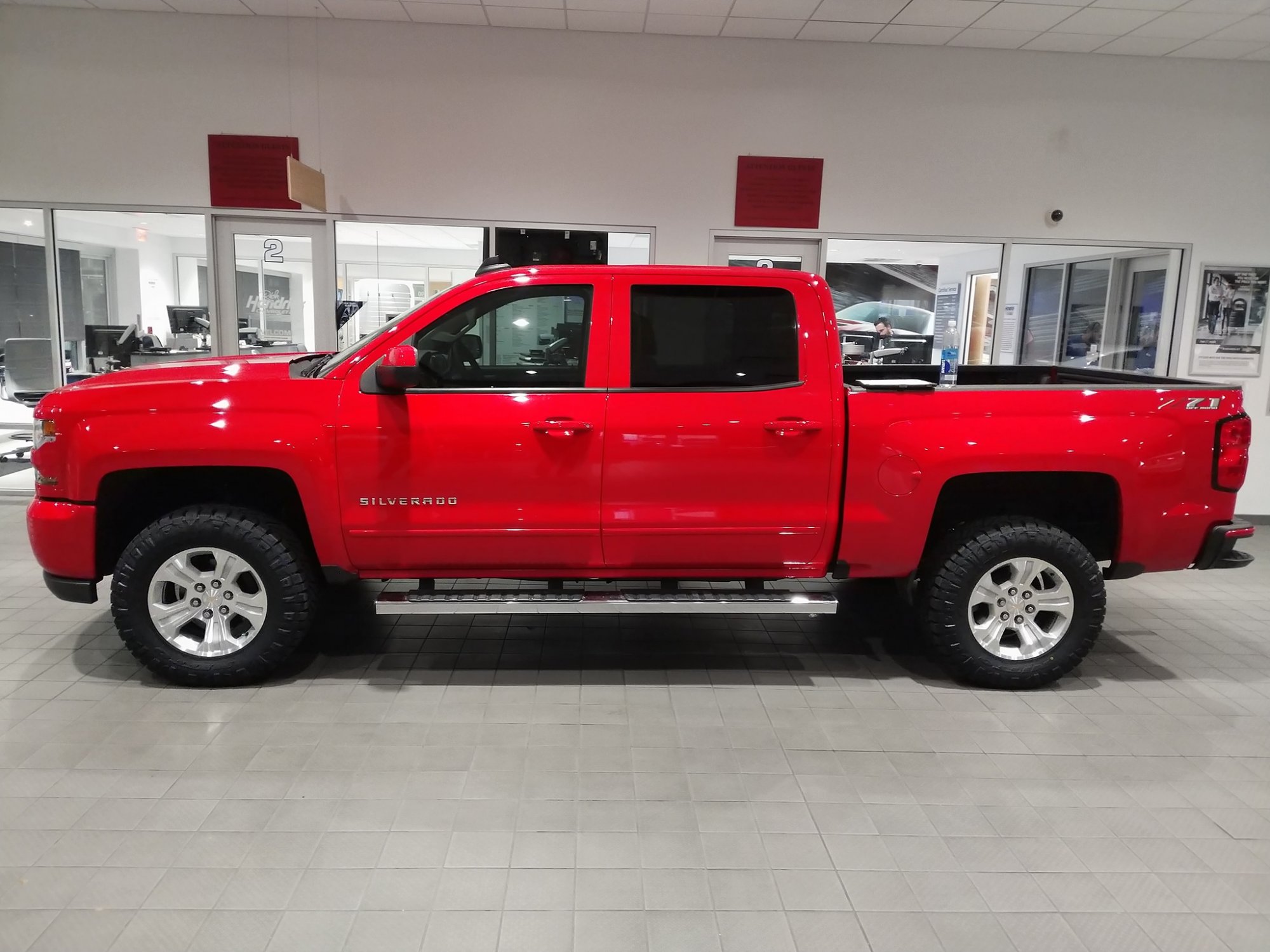

Here’s the leveled with horrible ride quality but had to get plus 1 offset wheels in order to work, 33” Nitto Ridge Grapplers
CST 4.5-5” lift with same wheels and 34” Nitto Ridge Grapplers
I’m all set with it and it’s the best mod I’ve done so far, lots of compliments.

After, sooooooo freaking happy! Zero ride quality change, 4wheelparts RoCkS!f572a32f7bbc6deb450264a50beec01d.jpg
