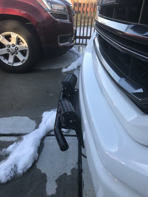

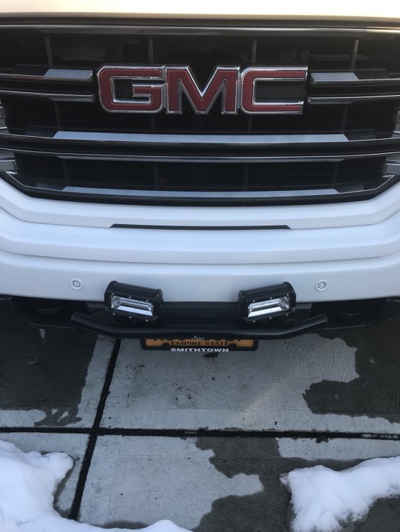

I do a lot of driving from Long Island to Syracuse and prefer leaving at like 2am. Wanted a little more light, while staying legal.
I ended up buying a cheapo bar on amazon and some pods which seem to be doing it for me. You could do a smaller pod and a sharper angle for your turns (?) just a thought.IMG_0620.JPG IMG_0621.JPGIMG_0622.JPG
What is the name of this bar. I want to add a couple 8" light bars I have laying around and aim them like this to add to my 32" curved light bar hidden in my grill.
https://www.amazon.com/gp/product/B01CEICZLC/ref=oh_aui_search_detailpage?ie=UTF8&psc=1
Definitely not the best quality, but it does what i need to do. Theres a few different brands on amazon.
