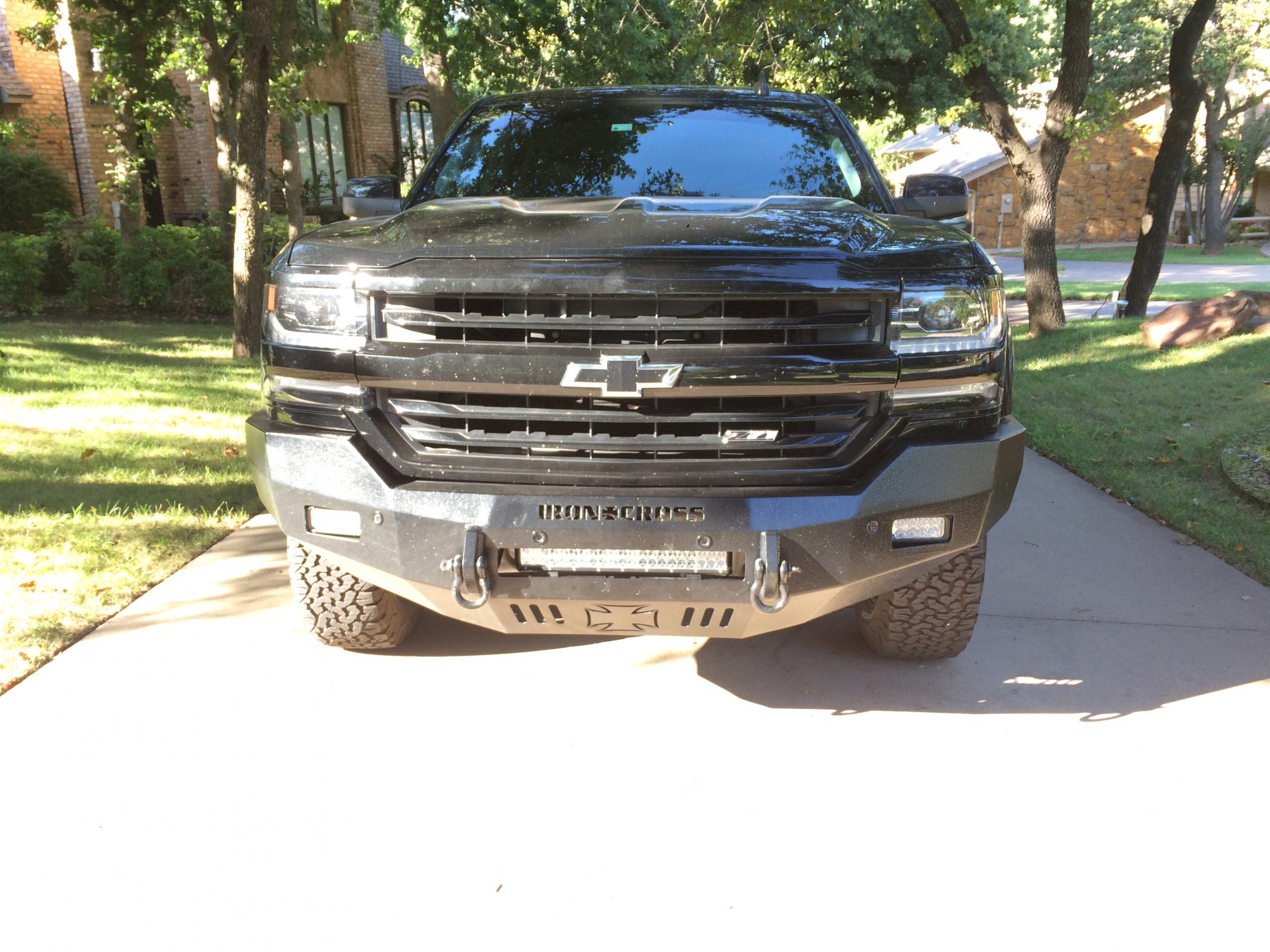

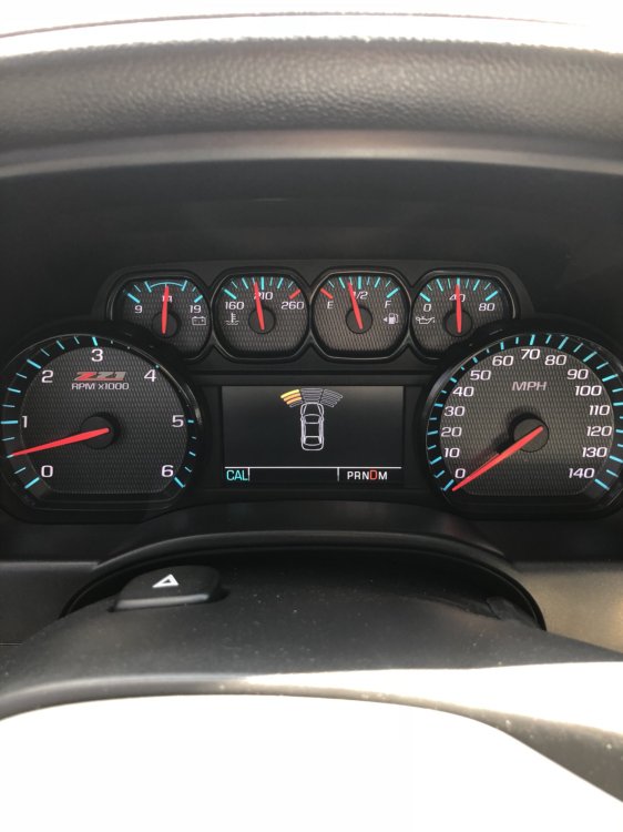

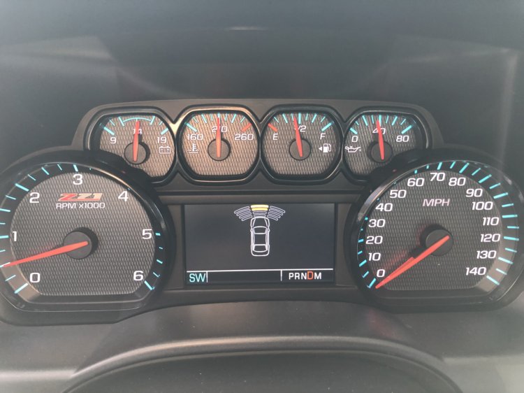

A few weeks ago I was able to upgrade/add my oem front sensors to my truck, most LTs only come with backing sensors but not the front ones and thanks to Pgamboa for his harness and whiteautoandmedia.com for programming my parking sensor module I was able to successfully accomplish this upgrade. Here’s a few pictures.
