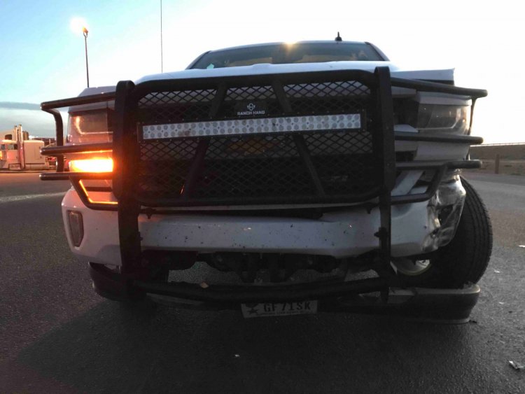

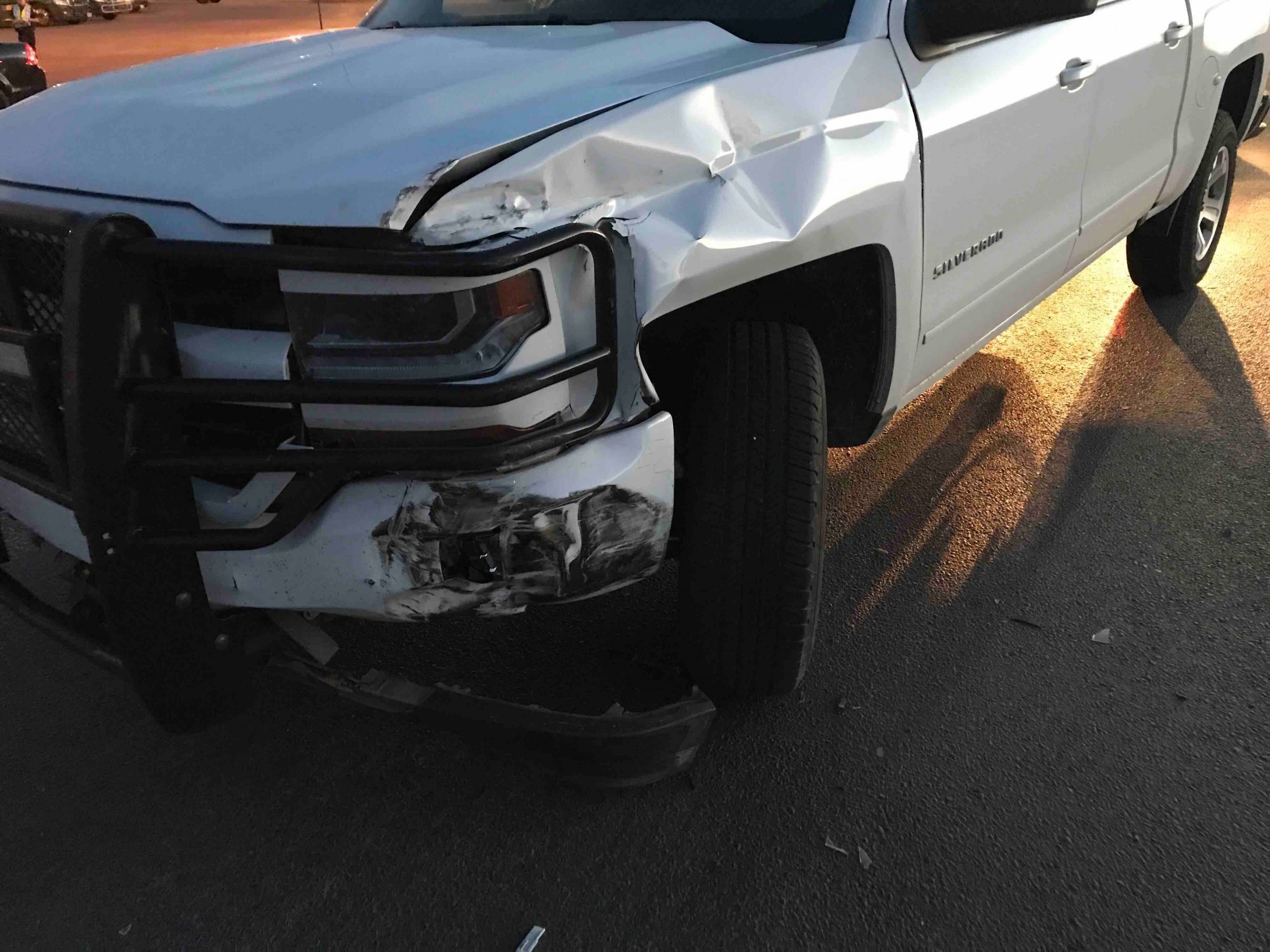

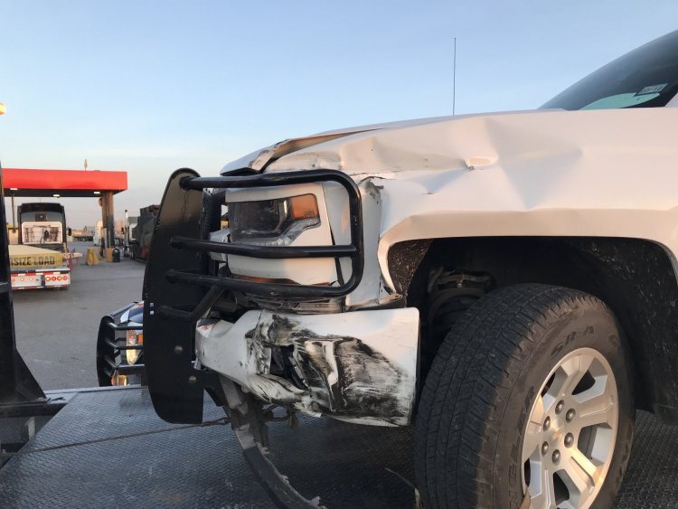

Long story short, 18 wheeler failed to yield right of way and his trailer/tires did a number on my front end.  Steering wheel was ripped out of my hands, coffee flew, I cursed, no airbags.  Truck has 93xxx miles and had no issues.......threw me around the truck pretty good.  Just wondering if they decide to repair what should I be looking for. Steering column locked up and wouldn’t even turn and lights/messages I didn’t know existed popped up on the dash.

Maybe a 2019!  So the inspector called today, the body shop pulled the from bumper back so it could be driven but the steering wheel will not turn at all so they are having another shop take a look because they cannot repair it.  Any thoughts or ideas why it won’t turn?  Trying to do my own research so I’m not fed a line of crap.  They are trying to get it towed and up on lift and check the frame.
Would be a good opportunity for new car replacement in your insurance policy if you had it!  That really sucks, man!  I'm not sure what might cause that, maybe the steering shaft got mangled or dislodged under there.  I did have a co-worker get his car banged up pretty bad and it was just below the totaling cost, then after the repairs, he found a hole in his trunk which would have put it over the edge for a new car... so it is worth walking around underneath all around with the shop, even where you might not think, and make sure nothing else is damaged from the impact that isn't in the front portion.  Also, check the electronics and make sure all the speakers and radio/CD player stuff works!
One thing you should do is look up fair market for what you would get for an equivalent truck with the same features (including your brush guard and light bar).  Having an idea (and a defense for a higher price because of mods, condition, etc.) would not be a bad idea to have locked and loaded if they come back with a low value price.  I've never had it happen to me before, but I'm just thinking about what I would do.
The steering rack is likely trashed/stripped. I would be concerned about the front of the frame as well.
Sent from my SM-G920V using Tapatalk

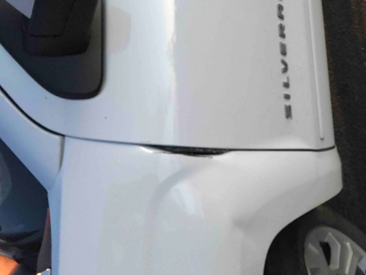

Check the gaps on all four doors. Open each slowly and see if they open normally or pop up or down out of alignment when opened because they are in a bind. Check the gap and alignment between the cab and bed. Check the body lines between the cab and bed.
Looking at the hole the frame punched in the front bumper I would just about put money that the frame now has a diamond rather than a rectangular shape. It happens when one side is stopped by an impact and momentum drives the unobstructed side forward. Any reputable body shop should be able to measure and verify the squareness of the frame.
The rack and pinion is trashed. They are really pretty fragile and don't survive side impacts very well. Don't let them try to replace just the left side components. All or nothing on this one for sure.

Update......Steering column, rack and pinion replaced, electronic steering box replaced and aligned and then they decide to put it on frame machine only to find out the frame is “tweaked”.  One incurance adjuster fired and damages at 12000 so far, fighting to total it but that’s what the lawyer is for.
