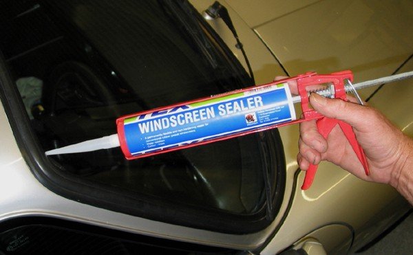

I often have customers coming to me with water leaks.
I take clear caulking and put a strip of it around all the windows, brake lights, roof antennas, and any other seam that could let water in. It takes about 20 minutes, uses $3 worth of silicone, and if its a regular customer, I charge them $0.00.
I you are careful, the clear sealant doesn't show at all.
