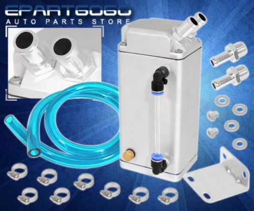

  If there is carbon deposits on your pistons that is smashing the spark plugs, I would either use SeaFoam to steam clean the pistons, or stick something in the spark plug hole to scrape the piston clean, or get a comparable plug that has slightly shorter thread depth. After that, get yourself a catch-can to prevent this from happening again. I just replaced a newer Chevy truck motor, and I was amazed how much oil was in the intake plenum and intake ports in the head. That all turns into carbon the the pistons and head.

What does this catch can do? Or do you have a link that is informative? On my phone app is kinda hard to sift thru stuff

      Well - basically a catch can reduces the amount of oil that enters your cylinders. An OEM engine sucks the oil fumes from the crank case into the intake (usually via the PCV valve), and burns those fumes in the combustion process. The oil fumes stick to everything, and forms carbon deposits on the piston and head. That carbon can cause pinging (detonation), spark plug damage, piston slap,  and so on.
      The catch can is a "filter" to remove the oil from the crank case vent fumes, before those fumes enter the intake plenum.
      The catch can needs to be emptied every so often, which is easy to do.
      Here are some pics and a link:
https://www.ebay.com/itm/Chrome-Square-Oil-Catch-Can-Reservoir-Tank-Mitsubishi-Eclipse-Lancer-Evo-Dsm/370907880575?hash=item565bd51c7f%3Ag%3A-pkAAOSw2FVbRpFR%3Asc%3AUSPSPriorityFlatRateEnvelope!98292!US!-1&_sacat=0&_nkw=chrome+catch+can&_from=R40&rt=nc&_trksid=p2380057.m570.l1313.TR11.TRC2.A0.H0.Xchrome+catch+can.TRS1.TSS0

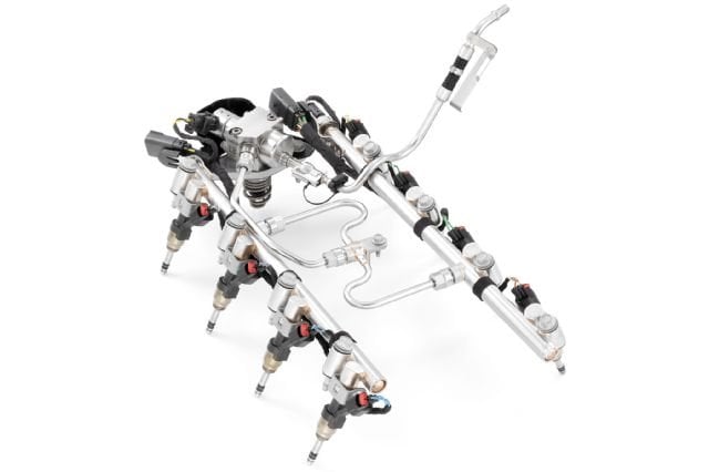

These injectors sit under the intake

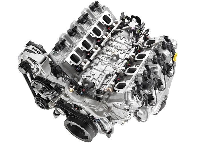

    The new design doesn't look difficult to work on, but it would be a little more time consuming to repair. Pulling those injectors looks like it would be about the same as replacing the knock sensors on a 5.3L (generation 3).
    Looks like some of the direct injection engines have specially designed pistons as well.
    From what i'm seeing, some vehicles have both direct and port injectors on the same cylinders.
    I look forward to working on one, it would be an interesting engine to take apart.
    Check out the pics:
