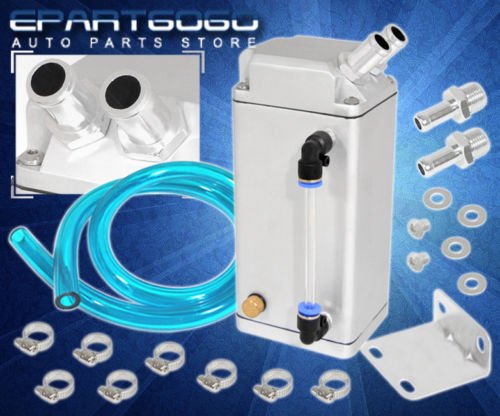

  If there is carbon deposits on your pistons that is smashing the spark plugs, I would either use SeaFoam to steam clean the pistons, or stick something in the spark plug hole to scrape the piston clean, or get a comparable plug that has slightly shorter thread depth. After that, get yourself a catch-can to prevent this from happening again. I just replaced a newer Chevy truck motor, and I was amazed how much oil was in the intake plenum and intake ports in the head. That all turns into carbon the the pistons and head.
https://www.ebay.com/itm/Chrome-Square-Oil-Catch-Can-Reservoir-Tank-Mitsubishi-Eclipse-Lancer-Evo-Dsm/370907880575?hash=item565bd51c7f:g:hvsAAOSwVtZaFcBk:sc:USPSPriorityMailPaddedFlatRateEnvelope!98292!US!-1
