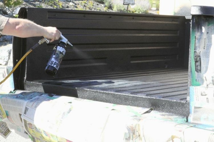

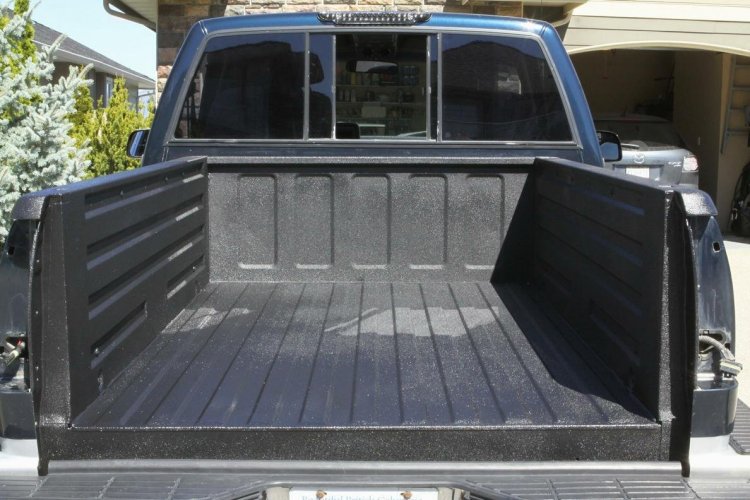

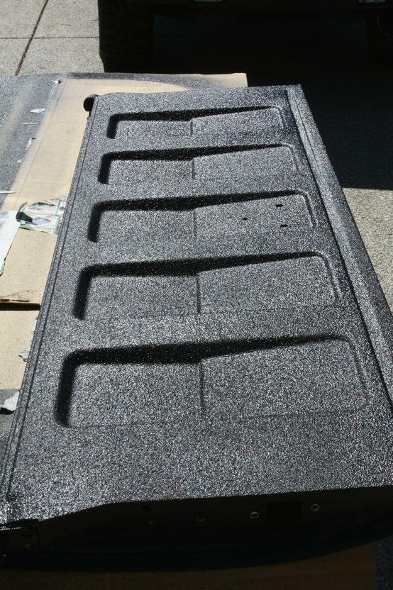

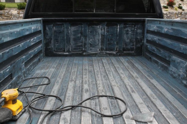

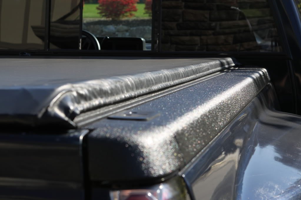

i used the raptor liner on my old truck.  i have linex on my 2014.  the linex is definitely better, but the raptor has held up fairly well on my old truck.  there are a couple spots where the raptor liner has chipped, but over all i'm still quite happy with it.  i don't haul crazy heavy/sharp edged stuff though.  mostly just boxes, goalie (hockey) gear, bass guitar gear, groceries.

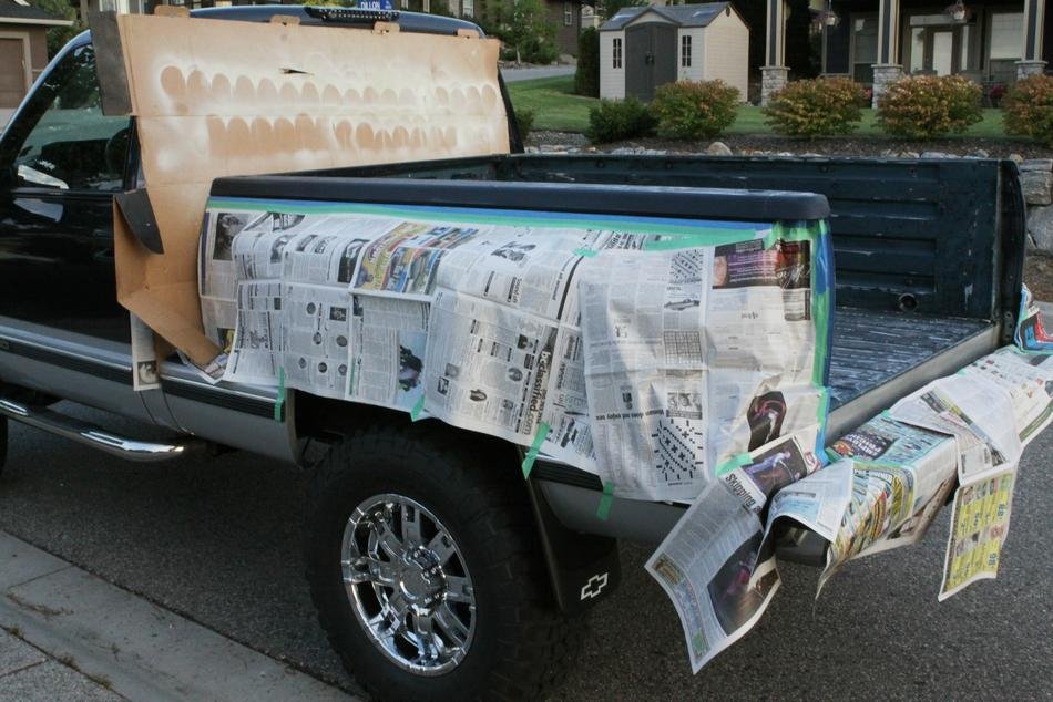

as others have mentioned - prep is key.  i sprayed mine outside, and while that's wasn't too bad, the wind kicked up for a couple minutes and blew some little things into the box - not the end of the world, but a controlled environment for spraying would be ideal.
i can't speak to how 'uv-proof' it is as my '89 has a tonneau cover
It looks like it has turned out pretty well. I would he spraying mine outside in the middle of an arizona summer. I dont think I'll use herculiner or the dupli-color one if I were to do it I would use the u-pol raptor. How was the quality of the material and provided sprayer?
it did turn out really well - i was/still am really happy with it... but again, i'm putting mostly 'light weight' loads only in the box
the sprayer worked fine (did the job).  it's nothing fancy.  if i recall, you can change the texture by adjusting the air pressure.  i think it was lower pressure = chunkier and higher pressure = smoother (but don't quote me on that).
one thing i will recommend is make sure your compressor has a large enough tank.  mine has a 25 gallon tank and it worked great.
also - this stuff stinks!!  one really good thing about spraying it outside is that it helps dissipate the smell.  i think the box really stunk for a few days - maybe a week, then it was fine.
and finally.... wear shoes that you don't mind throwing away becuz if you get some on your shoes it's not coming off.... and absolutely wear gloves!  i didn't get much on my fingers at all, but man that stuff was sticky!
