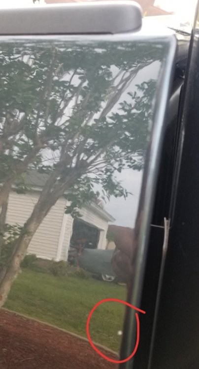

I've seen ppl gripe about the paint on these trucks and now I'm one of them.  My truck has 13k miles and hasn't seen a dirt road yet.  Some hwy miles but mainly commuting to and from work.  Been finding little chips like this in random places.  What's the best way to take care of these?
Touch up paint, but if that color is “ Pepper dust” or whatever gm calls it on the trucks it’s hard to get it to look right because of the blue undertone
I’d personally take it to the dealer and ask if it’s under warranty because the paint should be able to take some hits.
I got a few of those on my passenger bedside and passenger rear door.  The passenger rear door are actually pretty noticeable.  Told the dealership about them while in the 3yr 36k and they just touched them up for me.  Looked pretty good til I was clay barring and wasn't paying attention and pulled the touch up paint right out lol.
Gotta get some touch up paint and fill them back in.
I personally don't think the dealer would do much else.  I'd be leery of fighting for a respray... it's never the same in my experience...
Look at paint doctor, I think that is the name, you spread the paint over the chip and then wipe off the access with a special product that is not suppose to affect the chip fix. They show a video of how it works. I have not personally tried it but looks pretty easy.
Paint color is dark slate metallic (gmc) or graphite metallic (chevy) which would probably be just as difficult as pepper dust to match.  I'll stop by the local dealer and see what they have to say.  Probably need to grab some touch up paint anyway.
