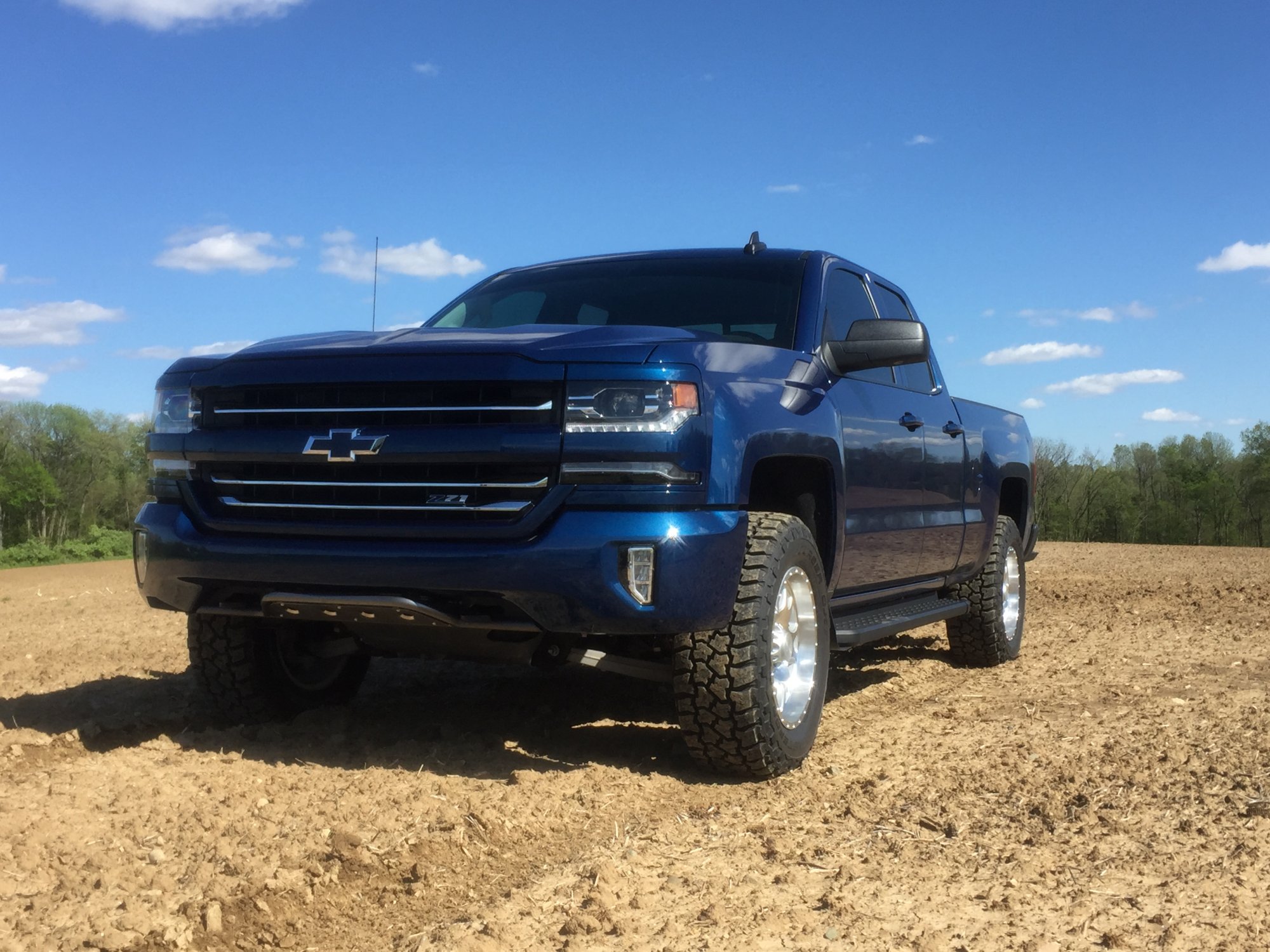

With a 2.5” level, 285/60/18 will be a little small. They are around 31.5” tall. The 275/65/18 is 32”. I have a 2” level on mine with 285/65/18 on 18x9 +12 wheels. The tread is flush with the top of the fender opening. With a -12 offset wheel, the tread would be nearly an inch outside the fender.
