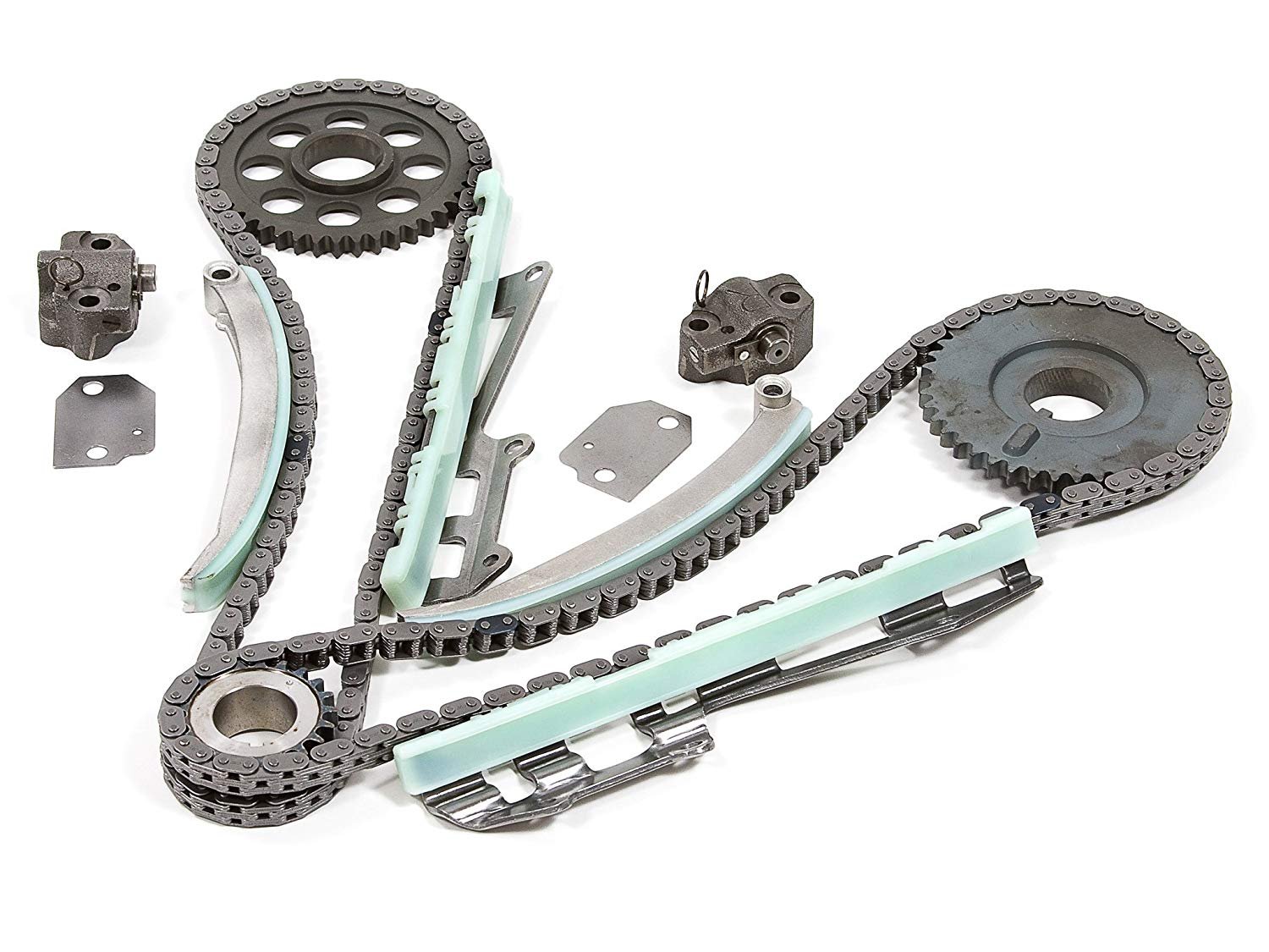

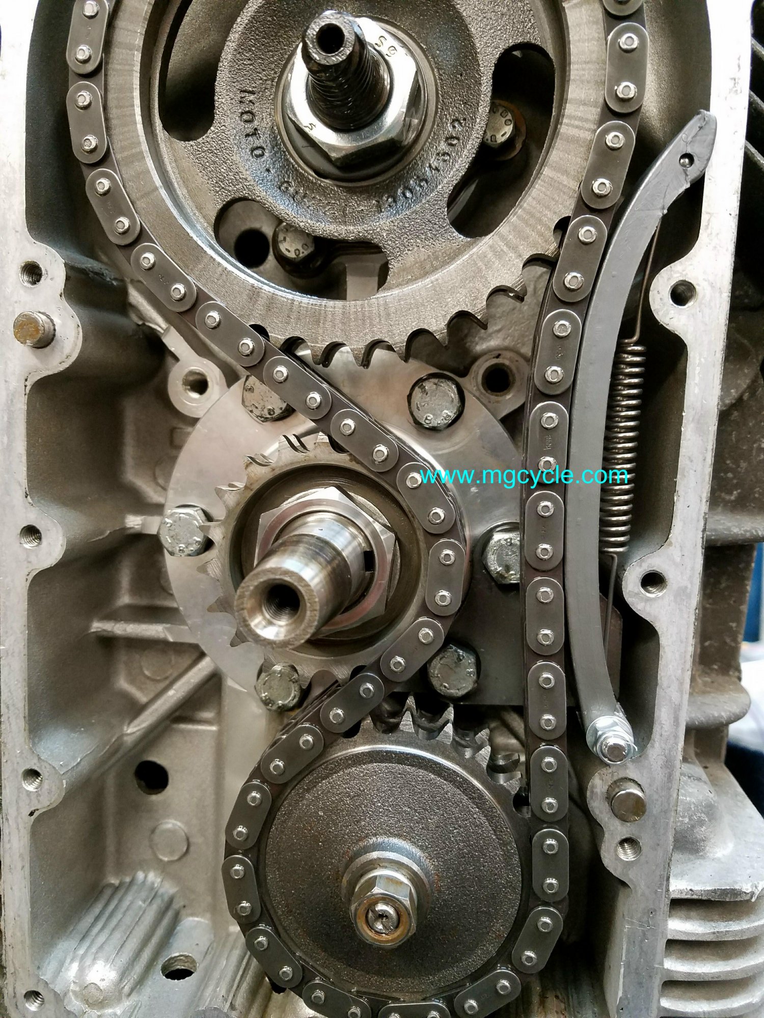

  A sound like that could easily be the valve train instead, which is directly controlled by the timing chain via the cams.
Examples of some different timing chains and valves trains:
(You can see why people feel that good clean oil will be beneficial)
