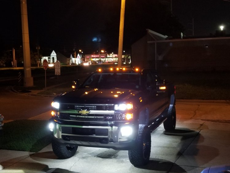

Heartlands LED's in my 2016 about a month ago and they are incredable and have a great light projection and No splatter effect of light. Crisp clean line on top level when shined on a wall or whatever. Very good product they sell
That looks killer
I went with Xenon Depot LED's for the highs, lows, and fogs. Installed the canbus with the lows for DRL compatibility. I'm very pleased with them. I've got a few pics on page 3 of my build thread.
Your truck looks mean as hell man! I really like the LED bars in the grill. What kind of lights do you have under it?
