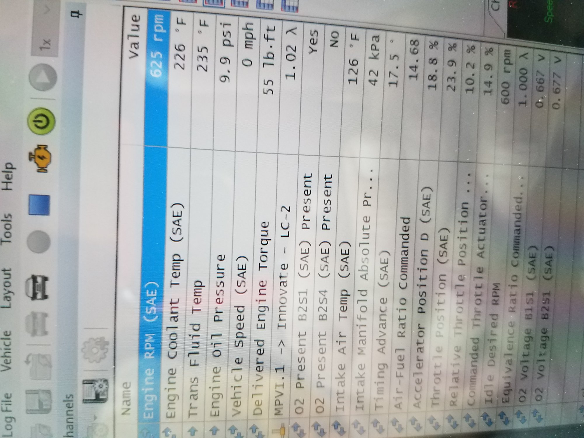

Here's a real hot idle after pulling a trailer up a monster grade at 70 plus.  Less than 10psi.  At normal operating temps I regularly see 12ish.   Outside temp 110.  I came on here for trans cooler suggestions and saw your post.  Motor only has a few thousand miles on it and so this was my first towing trip.
What is your oil temp when this happens?

I have not logged temp, but I'm sure its probably scalding.   Normal low for me is 12psi.   This is just the lowest I've seen and probably is from the high temps and thus the only reason I took a picture.   According to dealers 6psi is the minimum so apparently they don't care about anything above that.  The corvette boards recite roughly the same.  It should be noted that mine is a rebuilt motor as well and I'm more interested in whats normal in case I want to take it to the shop I had it built at.  Some say cam bearings could cause this as well as an oil pump.
Please do next time you tow as that is contributing to your issue.  Judging by the coolant and trans temp and description of use, I would guess your engine oil exceeded 260 degrees.  Do that with thin oil and you get really, really thin oil....

Being in the desert and towing up big grades I was half expecting temperature problems so I put a 30 or 40 weight in it before I left.
Not sure why some choose to keep a razor thin margin for error in these not inexpensive machines. The 0w-20 spec was made to save .1 mpg for federal mandate and not to tow a trailer up a hill at 70 in the heat. Put in thicker oil of your choice or risk it all its your choice. Do a Used Oil Analysis on this fill and see if there are some bearing metals in the oil. As the bearings wear the pressure will get even lower accelerating the wear. Good luck
