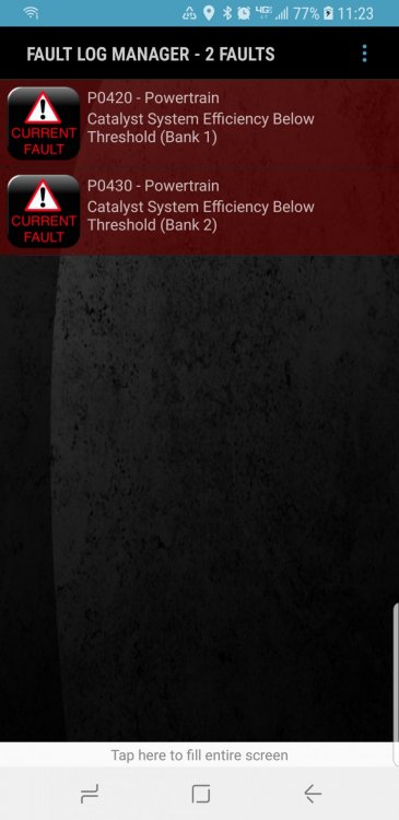

I have a 2007 Silverado 5.3 LT, Z71. I have had a check engine light on that had been on and was a P0420 code. I changed all the O2 sensors and reset.  It came back on it within 100 miles. I have dealt with it for awhile and I just checked the engine codes again and I have a P0420 and P0430 codes now. The truck seems to run fine and I did just change all coil packs.
Any ideas? Screenshot_20181008-112330_Torque.thumb.jpg.c64a1aca6e4b769df9235f602121abb9.jpg
Stop wasting money. You. Need catalyltic converters.
