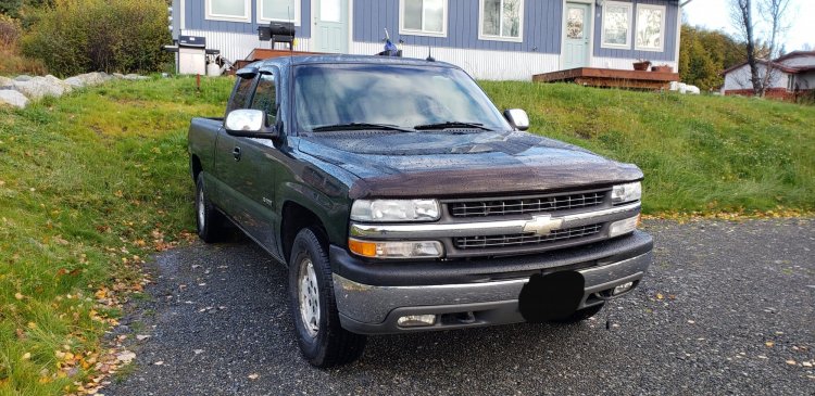

Here are a couple pictures:
2 minutes ago, Black02Silverado said:
Also, depending on what you want to spend on it.  A tune from Black Bear Performance will make a nice difference.  At least it really woke mine up.
Yeahh if it woke it up that must be crazy! This thing is like on 500mg of caffine compared to my tuned tacoma I had. (2017) Some call this a "down grade" but I feel as though it drives nicer than the tacoma did.  Toyota really messed with the tune/transmission/engine in that truck. I hated driving it. This thing makes more power everywhere! Even my girlfriend likes driving it more and she has only driven those two trucks!
