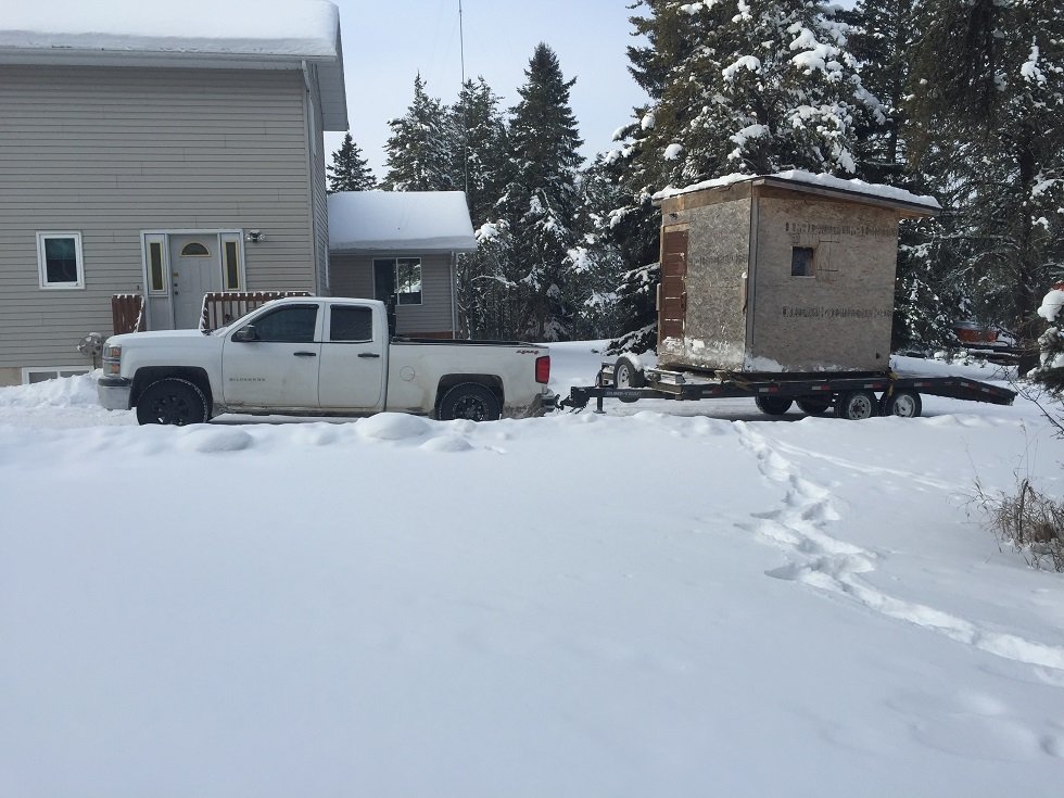

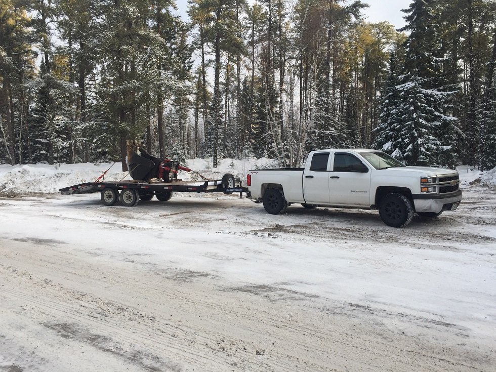

I have a 2017 Silverado Crew Cab 4x4 with a 5.3/6L80E/3.08 set up. I've towed 5k lbs with it in the snow with no issues, I run BFG All Terrains year round. I would think with a good tire and common sense driving a crew cab truck should have no worries. Stopping has been sketchy a couple of times but slow traction and getting through drifts has never been an issues.
Here's a load last winter in front of Mt McKinley on the Parks Highway.
