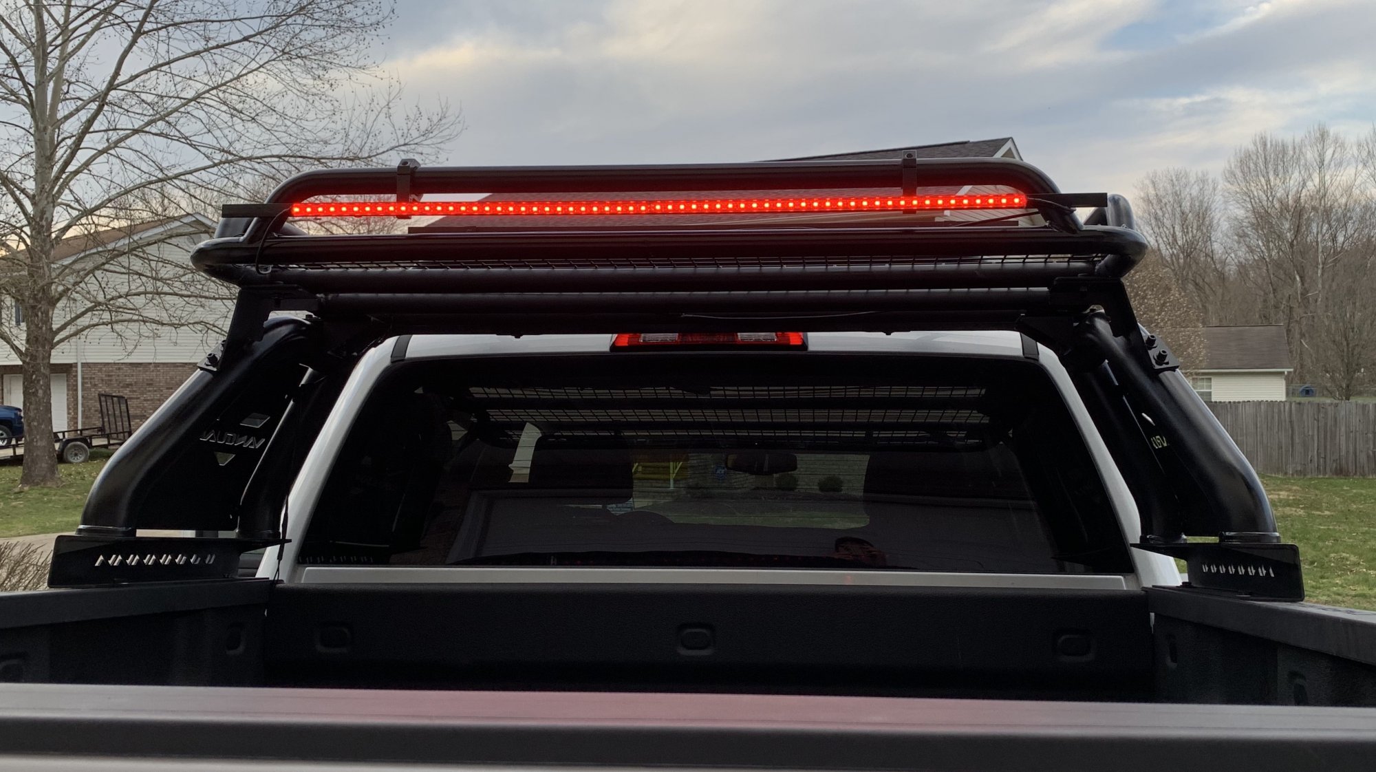

I’m installing a light strip I got from diodedynamics. Their stuff is guaranteed for 3 years and very reliable. I have it hooked up on a roll bar rack but will probably tap into the running lights that connect to the taillights.
Here’s an update. I ended up wiring to my fog light fuse since all my other hardware is running from the same juice. There’s very little current being drawn since they are leds. I’ve had no led failures from this company,
