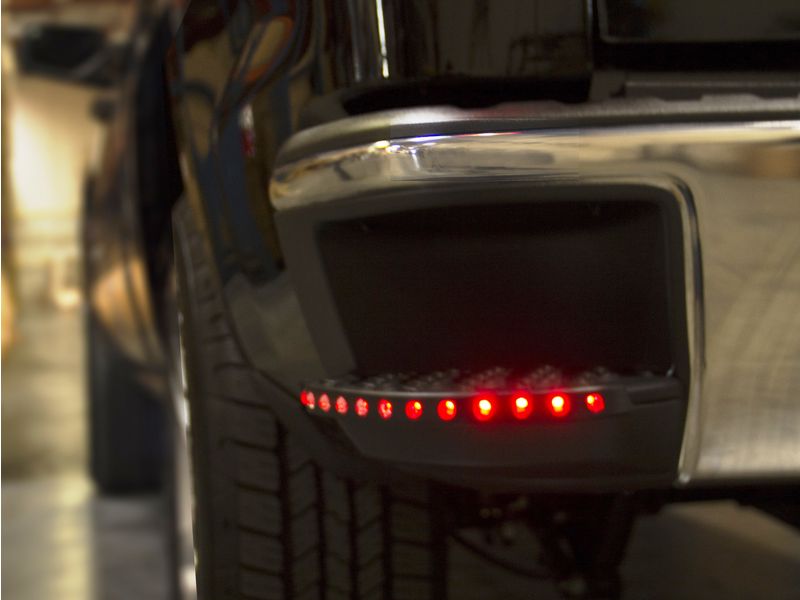

Looks nice any delay? I bought the OPT7 but have not installed yet. Heard a lot of people saying there is a delay.
Thanks
I haven’t noticed a delay
