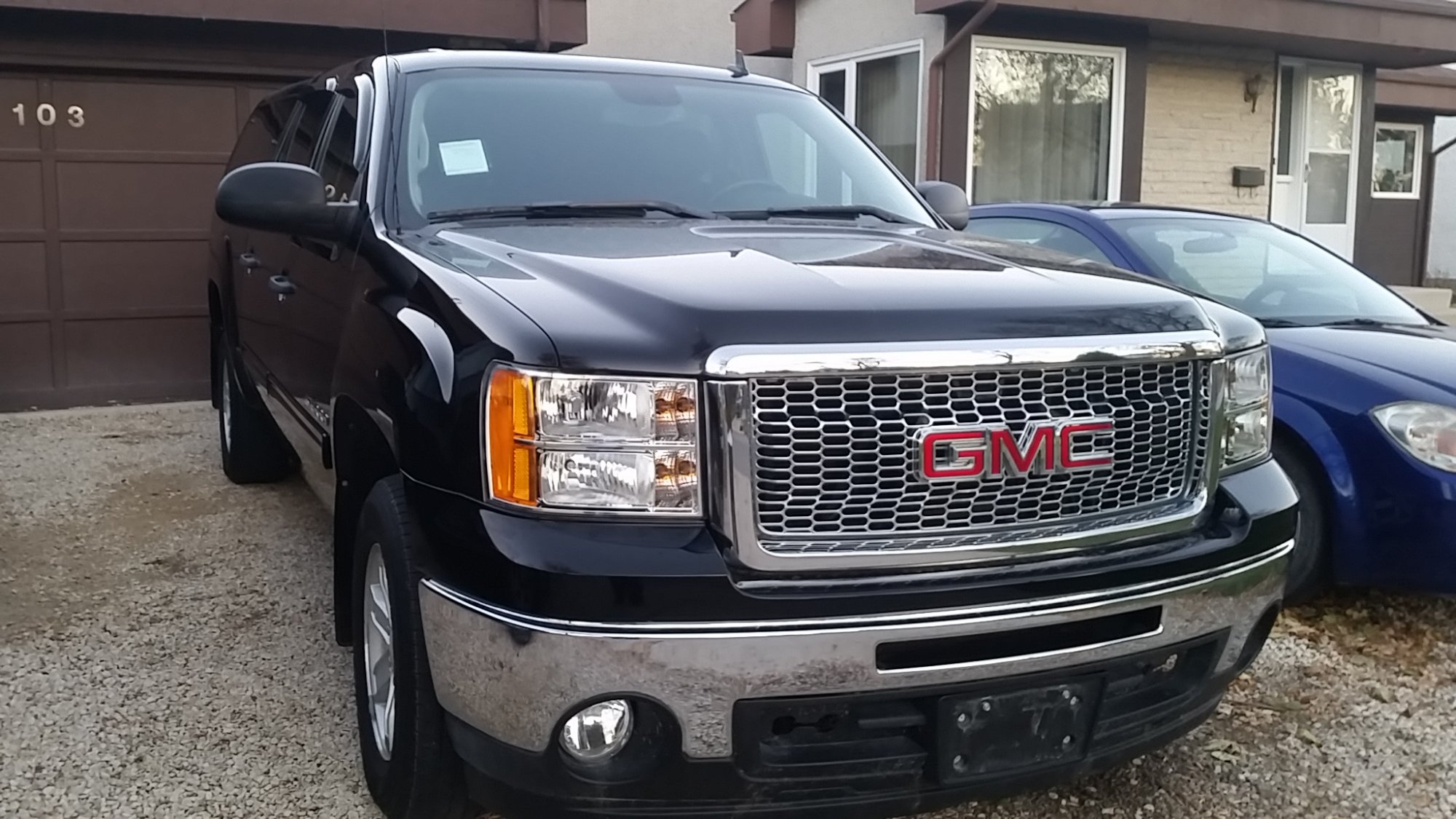

Hi all.  I have a 2011 5.3 Sierra.  Just got the truck and know nothing about tunes.  All I basically want to do is disabled the AFM.  Maybe do a little adjusting in the future.  Only 23 thousand miles on it.  What is a good tuner to buy for what I want to do?

Congratulations on your find! Post some pictures.
