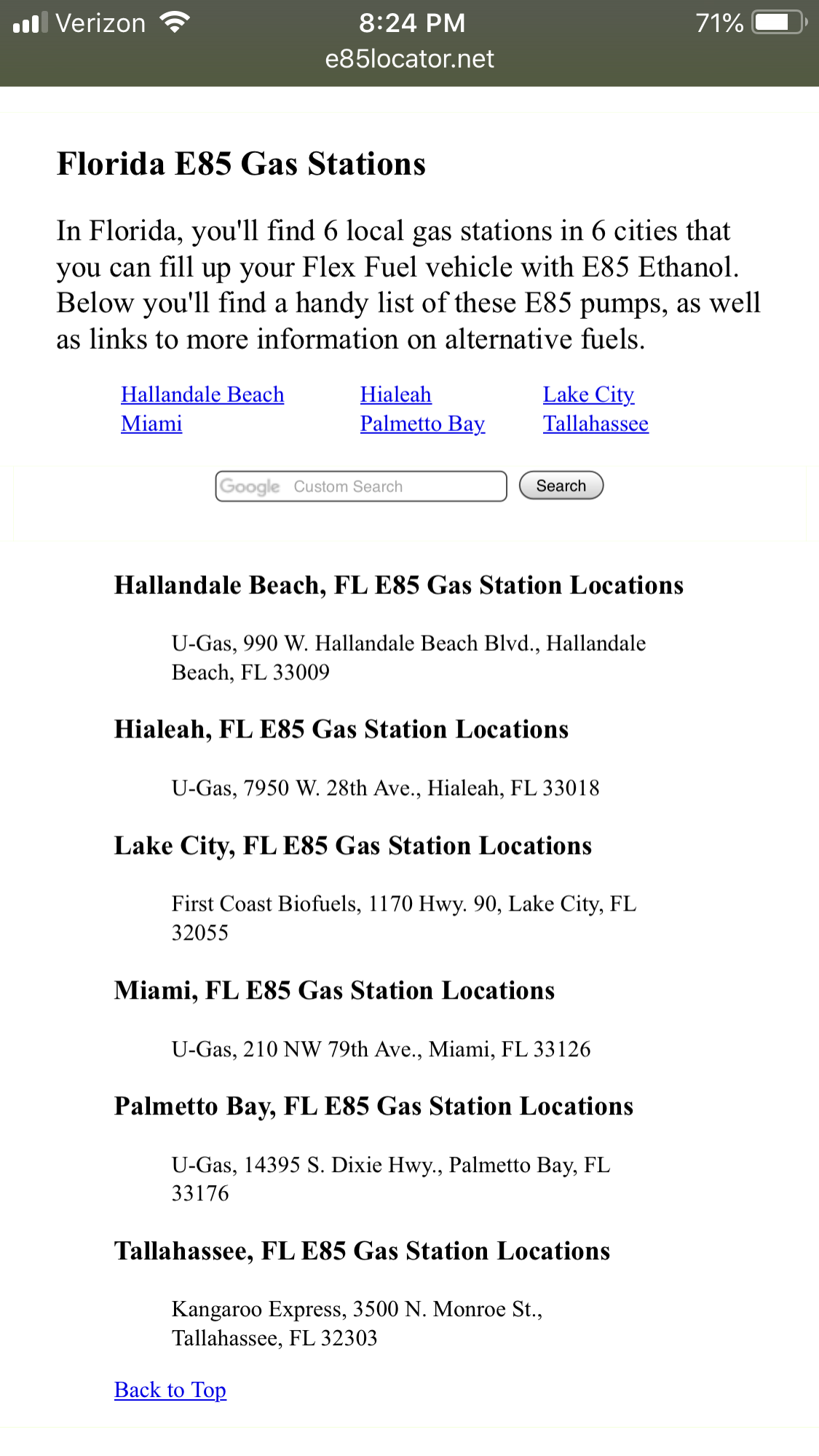

Yeah, I saw that done on a Yukon. I may look into it but E85 is to my knowledge not easily found here. I looked on the E85 locator map and it shows it is available, it is not. The Exxon, Sam’s club and Gatlin they all carry gasoline with up to 15% ethanol but most have 10% ethanol. So that tracker map is not right. Thanks though for letting me know it’s possible ?
According to what I’ve found, in all of Florida there are only 6 E85 fueling stations. Closest one to me is 165 miles away.
Edited by SS502
