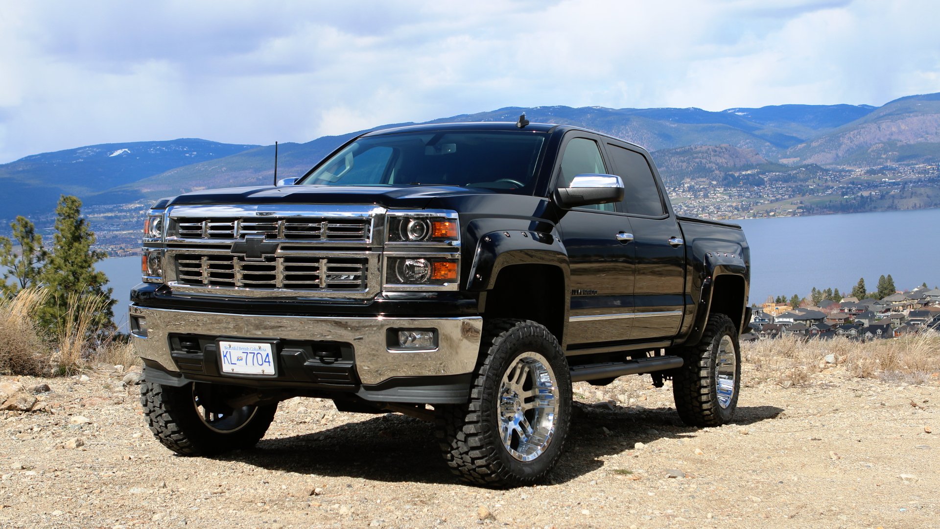

hey abninf101st
i can't help you much with most of your questions since i've got a v8, but i lifted my '14 with the 7.5" rough country lift and 35s.  in terms of drivability i find it's fine and love being up that high (can just see so much more).  i know there are a lot of guys that say rough country isn't any good, but i've had no issues with mine.  now, with that said, my truck is a total street queen!  ha! ha!  i just love the look of big trucks - always have, always will.  if you're looking at doing a lot of hard core 4x4ing then definitely pay the $$ and get a 'better' lift, but if you're like me and it's the look you are after, then from my own experience the rough country lift is fine.
