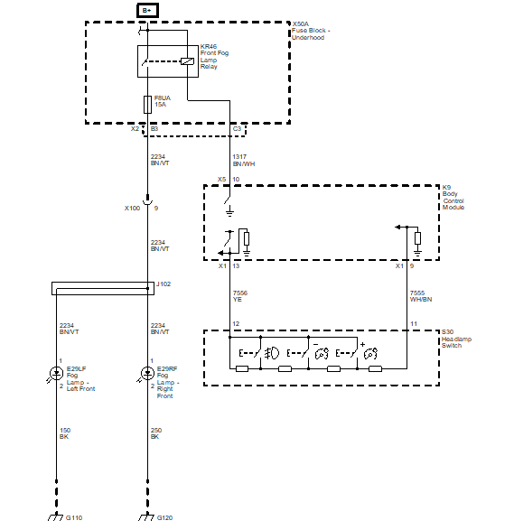

Anyone figured out the jumper hack to get the fog lights to work with high beams?  I know it's pretty easy to do this for the K2 trucks, but I looked today at the brown connector plug on my 2019 -  seems much smaller when compared to my old 2016.  The connector and the wires are smaller.  Appears to be a real PITA to get the diode inserted.

ETA: I called, they have not even looked at the 2019s yet.  I checked the Body Builder manual, and the wire colors are the same for the two light control wires, and the positions in the wire harness are the same.  I guess that I will be a beta tester for them and go ahead and order one.  We shall see.
Ordered. Should be here Monday.
Boost Auto Module arrived and installed.  Works exactly as advertised in a 2019 Sierra 1500.  Wires are exactly the same color and place as the install video instructs, zero changes, zero problems.
It even works with a Speed Turtle 3.0 Flash Module in case anyone looks at this later.
