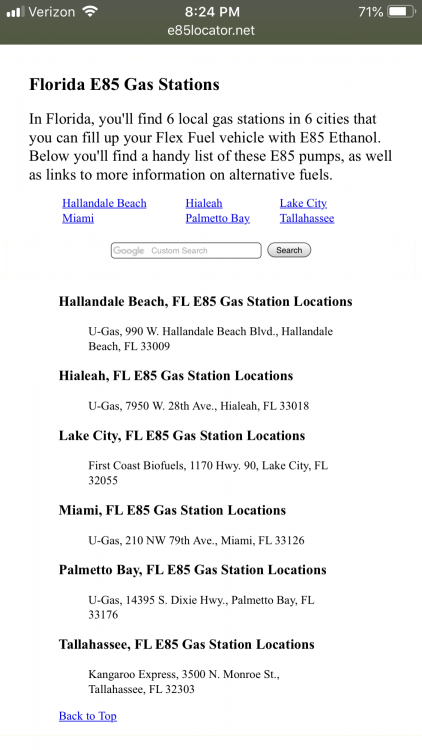

Please, if possible I’d like to hear NON E85 suggestions too...this tuning is all new to me. I know I can convert to E85 with my 6.2 (2018 so tranny tune is too involved) but I have no place to buy E85...well I can but it’s 170 miles away.
No E85 - no worries.  You are probably already running premium fuel as you have the 6.2.  From my reading, it appears that tuning the trans makes the biggest difference to how these trucks perform.  Yes, adding 40hp is great but not if you have torque management stopping you from putting it to the ground.   TM is just one aspect of the trans that can be modified.  I think you need to actually send the TCM in to HP Tuners to be unlocked.  Once completed, they return it to you and you or your tune shop can make the changes to it and the ECM.  It is also possible to purchase a TCM to send to them so that you can use your truck while they are unlocking it.
