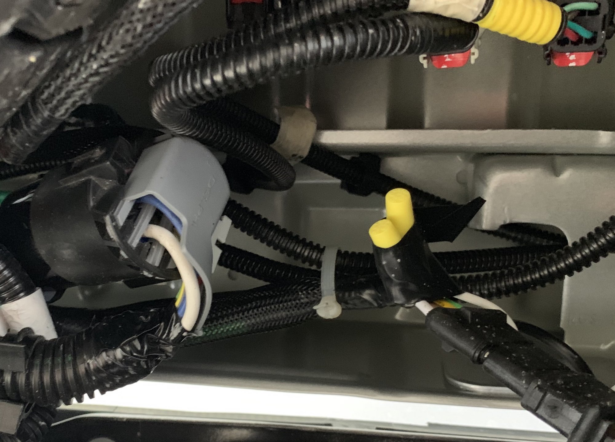

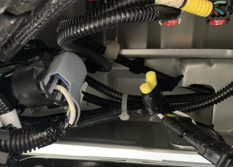

Are the two yellow things wire nuts?
Please I hope not.... mixing auto stuff with home stuff.......Ugh???...
yes, guilty. it was sub zero when I installed the light bar. It’s tight, got dialect grease and taped, come spring I’ll do it correctly with shrink tubing
Atleast you came clean about your work. And the fact you plan to do the proper repair when it gets warm.
Yea at best a splice connector but I just solder and heat shrink you will never revisit it ever.
