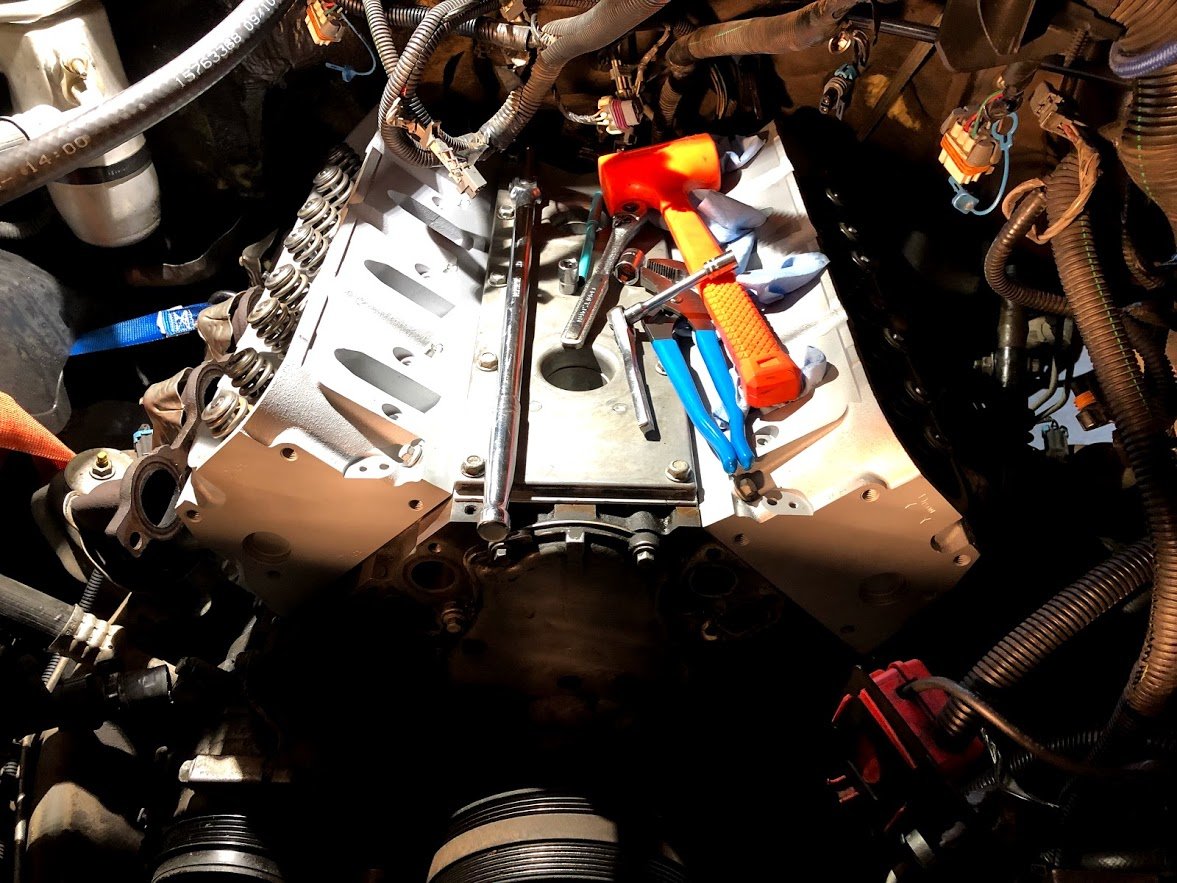

Hey guys,
I had some bad luck recently with my 2004 silverado z71 5.3. I had the 706 castech heads and they finally gave out on me causing the truck to overheat. Took it to the shop and they wanted 3 grand to do head gaskets using the same heads apparently they were clueless to the TSB on the castech heads. I found a guy that rebuilds heads and picked up a set of 799’s and had them milled .030. It took me 3 weeks off evenings and weekends but I finally got the new heads and gaskets on with every bolt double checked used properly torqued specs/angles etc. I also replaced all lifters,trays, and pushrods, oil sending unit, knock sensors, heater hoses, and upgraded to the larger radiator from 2005 and up trucks LOL. The truck fired up first try and runs great when cold, however when it gets to operating temp the idle is very rough and acts like its missing. Should I be looking for a vacuum leak? any suggestions? Thanks for the help.

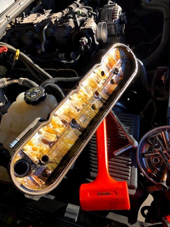

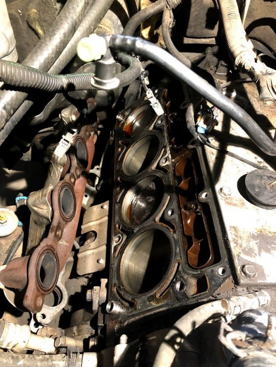

Glad you got it fixed.   Just curious as to how many miles are on the truck.  The valve covers looked really clean.  Also the cylinders looked in great shape as well.  Not much carbon build up.
173K miles. I am OCD for changing the oil on time or EARLY lol. The first photo is of the motor after I pulled the heads. There was quite a bit of carbon buildup that took quite of bit of elbow grease to remove but I figured I was already there why not do it. What it did notice is that there was almost 0 sludge buildup at all. The power difference now with the new heads is very noticeable or it could be its just because it hasn't been that clean since new. It has been a couple of weeks and I just changed the oil for the second time get the residual dirt/grime that may have accumulated during the repair. No CEL, no issues and I just upgraded my 105 alternator to a 145 amp.
