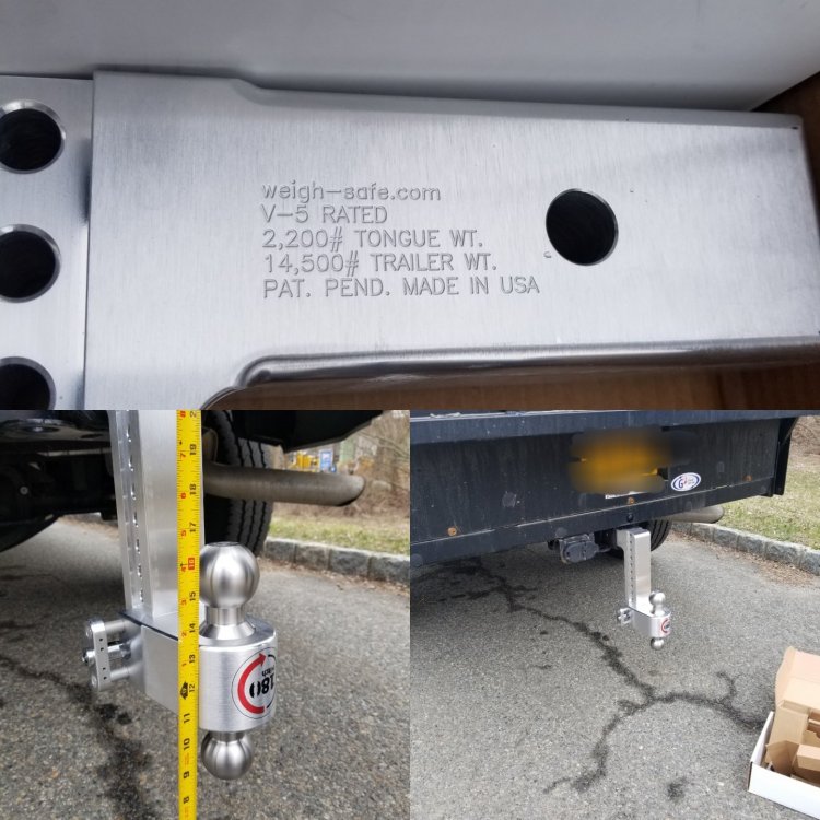

I’m curious what size drop hitch are you guys using for your Tahoes? I’m measure 25” to the inside top of my receiver. My trailer sits level at 17” measuring to the bottom of my trailer’s coupler. That said, I know an 8” drop hitch would work.
Im thinking about getting the 10” Weigh Safe drop hitch to give me more versatility as I have multiple trailers. The hitch itself actually drops 13” from the top of the receiver so without load, I’m looking at 12” of clearance, does any one run one of these or see an issue with only 12” of clearance?

Did you do the weigh-safe?
I had good luck with them. Mine was 21" to the bottom. Its a Class V different but the same.
Same deal was listed 17" trailer, I did not get the scale version but would have if I knew it was an option. I did not need as much as I thought but the 10" will allow me to do smaller trailers.
