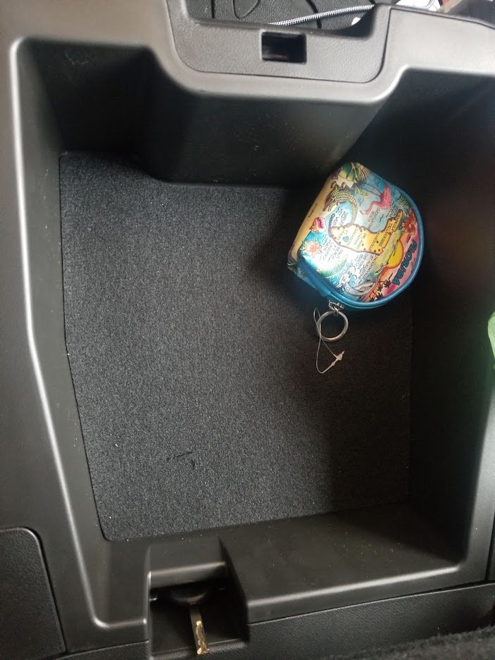

This is the pocket on my 2019 1500 with middle jump seat.  Notice I am using a key without a fob, I had some extra keys cut since my tonneau cover (Extang Encore) is keyed to my trucks little key inside the fob.  Didn't want to fumble around with trying to get that little thing out when I wanted access to the front section of the tonnea cover.  Was able to program these keys to be able to start the truck which is sweet to have some inexpensive spares.
This was the keys I bought, you can actually find them on other sites for cheaper if you want to shop around.  OP, sorry I know you already know about the transmitter pocket but may be useful info to others.
