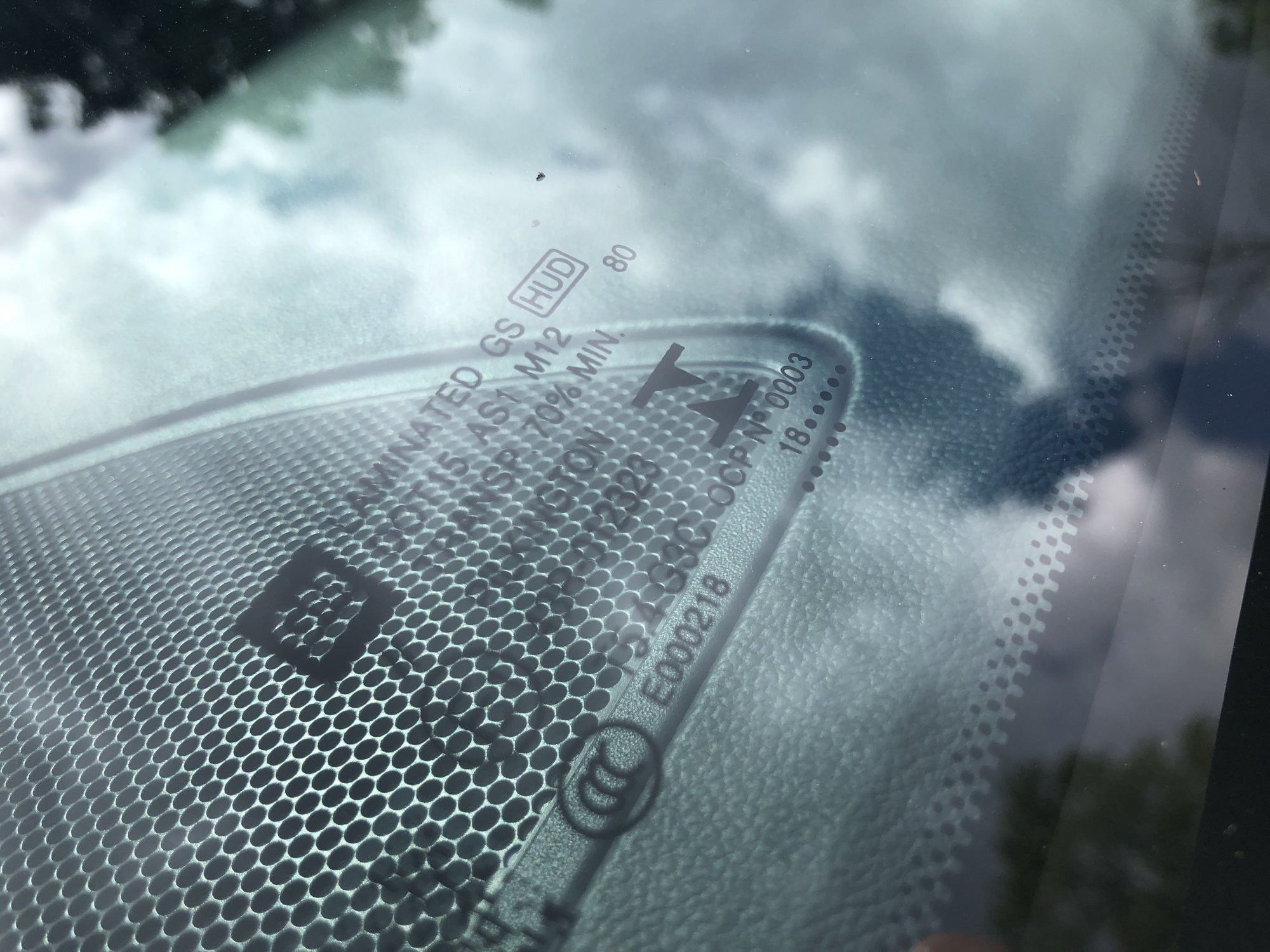

I have the HUD and the windshield is stamped “HUD” in the corner. I suspect that trucks with forward collision alert/ safety package II (but no HUD) also have an HUD-ready windshield since it flashes the alerts on the windshield. So it would be an easier journey to add HUD if the truck already has that package.

Where is that stamped?   Drivers side or pass?    I have the Safety Alert (RED light),  but I dont see HUD on mine.

Passenger side at the bottom. “HUD” is written in a little box.DFDB34A3-59DB-4A32-91C3-E0A521A93877.thumb.jpeg.dfd560aecf1e193947f8b8404bdce0b6.jpeg

Unfortunately I was not that lucky.     Mine does not say HUD.    I can't tell,  can you read the part number for yours?
Darn, there goes that theory. I don’t think it’s GM part number, but it’s Pilkington 43R-012323. The rest I think are just DOT certifications and whatnot.
