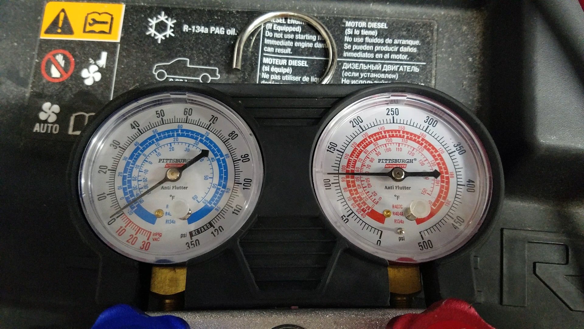

This is what the gauges look like. Why is the low side zero?
No pressure on the system I think. I know when I replaced my condensor I pulled a vacuum on the system to help recharge it and got the gauge on the left of the vacuum pump to -30. Then with the gauge that comes on the freon can I took it to 35psi. Maybe use one of the gauges that comes on those canisters to see for sure

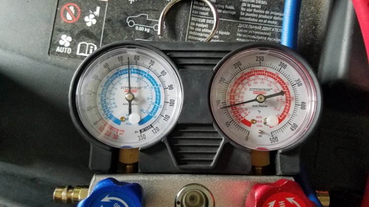

This is the pressures this morning with the compressor off. I wonder if my low side gauge wasn't hooked up right. It short cycles with the a/c commanded to come on. 1-2 seconds on. 10 or so off.
Shoot a video of the guages while it is cycling
