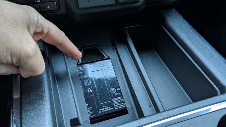

Just noticed on drive to work this morning that the pad seemed wet. Phone was not near this area since I use AA with the cable and it stays in the cup holder area. What is happening?

I'm in Florida, the AC is used every day, every morning, and every evening. Today was the first time this was noticed. It's been colder and warmer than today in the last month, but today the pad was condensing enough that it seemed like water was flooding up.
My buddy had a loaner Sierra a few weeks ago and got curious about the pad, pulled it off and found that it is in fact cooled by HVAC.
Well there you go. I figured it was bc of the heating factor when charging. Most charging pads have a fan or cooler built in

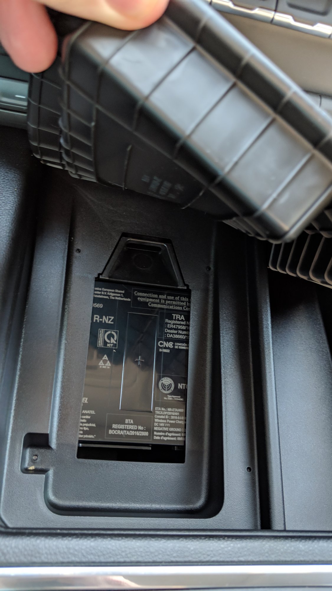

I didn't realize the rubber piece lifts right up. You can see the AC duct here and feel the cold air when the AC is on. Odd that today was the first day time I've noticed the moisture.

I noticed shortly after I got my truck that the pad was cold to the touch. HVAC directly behind it explains that I guess. As far as charging speed goes, mine charges slowly. Still pretty convenient though.
