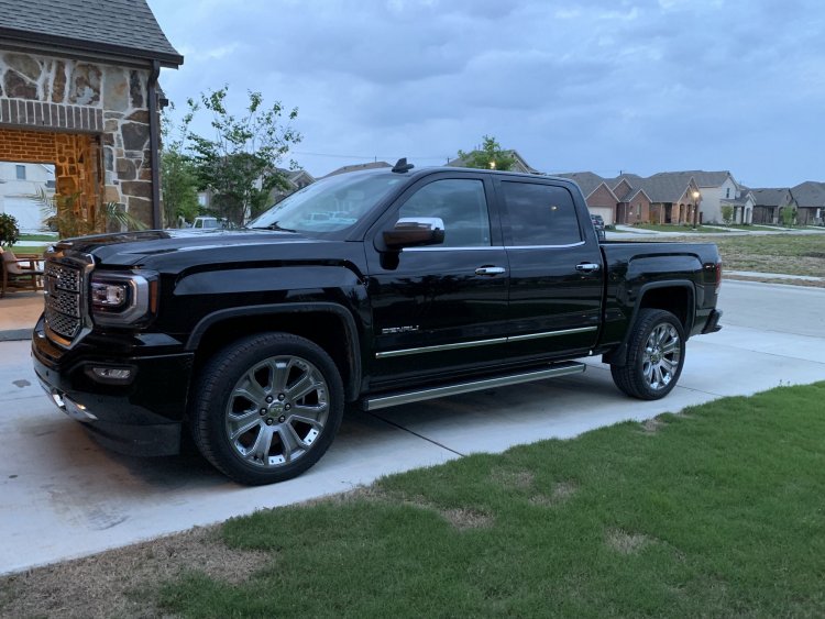

Hi everyone, new to the forum here.  My 2005 LR3 took a crap this weekend, after 13 years of service with me I was upset to see her go, but DAMN!  This Sierra Denali is an outstanding truck!
The truck is a 17 Sierra Denali Ultimate with the 6.2 and 90k on the clock.  High miles but the truck is in excellent condition and rides great!   I am simply amazed with the power, comfort and tech that has been packed into these trucks.
