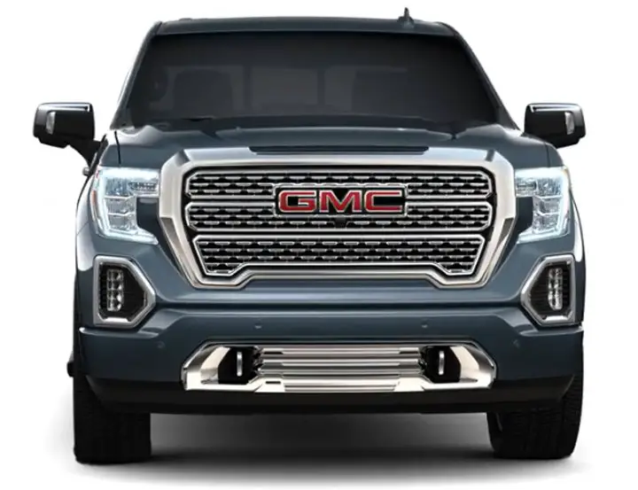

You'll note the SLT grill is different from the Denali or the AT4.
Here are photos of the Denali and AT4 grills ..... these are off the internet.
I could be mistaken but the AT4 grill looks like a painted SLT unit.
The SLE  SLT and Elevation appear to share the same grill
The one pictured below does not have the Technology Package.
I VERY carefully examined all the SLE SLT Elevation and AT4 on the lot and hey all had the same very slightly raised pad area for the camera.
