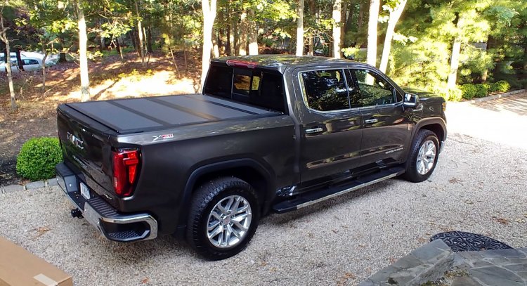

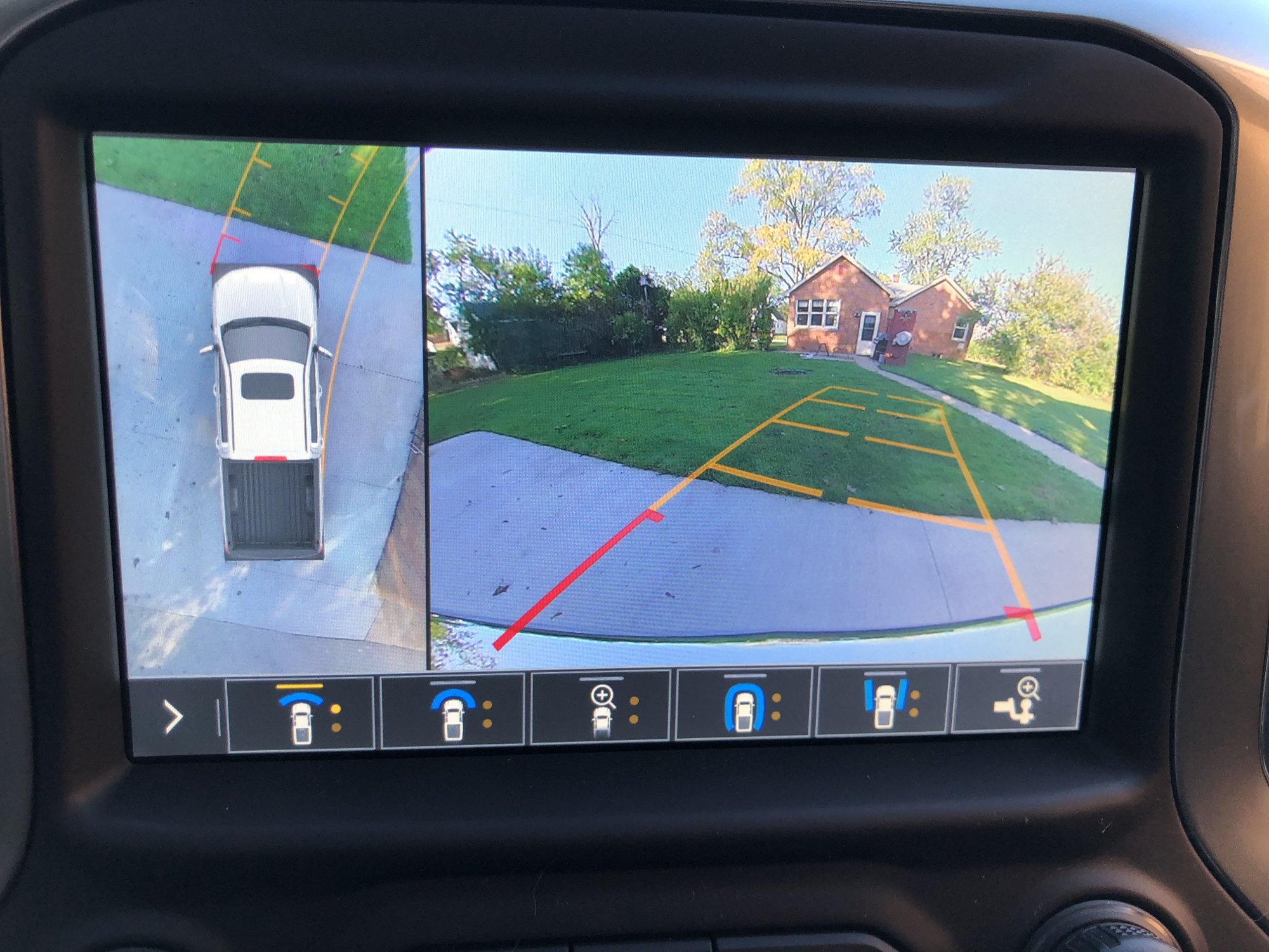

The reason the front cam is missing in the 360 view in that picture is because you are using it as front view. Its only one camera and can perform one view at a time. So if you have the front view up and 360 the front will black out. If you have it in 360 with the rear view then the front will show. The rear cam has two cameras to accommodate the dual view.
He simply does not have a front camera. Two cameras aren’t needed, the back only has one (the other bubble is a light). All of the views are stitched together with software to make the birds eye, but you can pull up the front or rear cameras in the main window and maintain the full 360 view. 360 would be pointless otherwise, if the direction of travel wasn’t able to be seen in both the main window and birds eye simultaneously.
Thanks for stepping in and better explaining my lack of a front camera.
Since I don't plan on towing a large trailer and have no need for the trailer package ( I have it only because it was on an IN STOCK TRUCK )
is there a way to substitute a front camera?
I would really like to have the view you pictured.

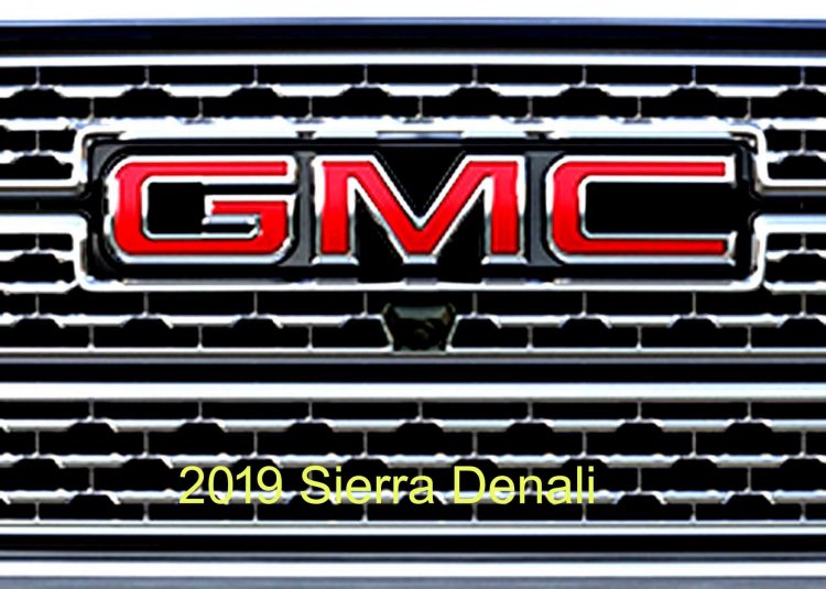

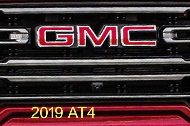

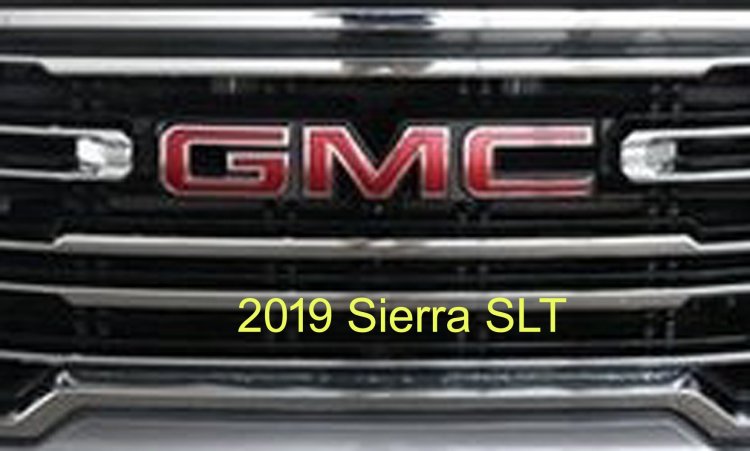

I haven't gotten to take my own photos and measurements yet ... these photos are off of the Internet.
You'll note that the AT4 and Sierra grills are almost identical, with the exception of the camera on the AT4
The Denali seems to mount the camera slightly higher but as I said, these are not real measurements.
Fabricating a mounting bracket, if need be, to go between my existing grill and the new camera should be a simple thing.

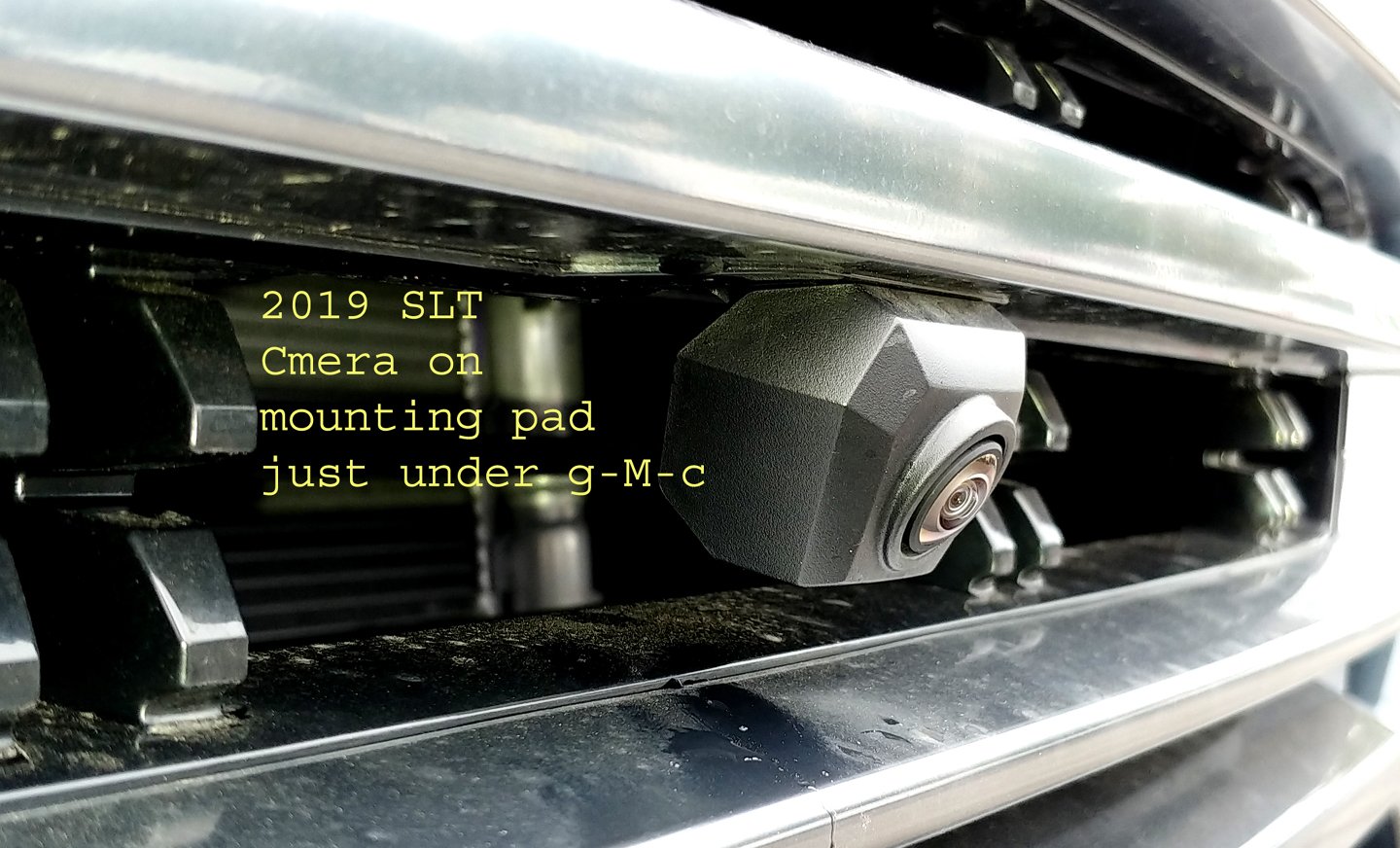

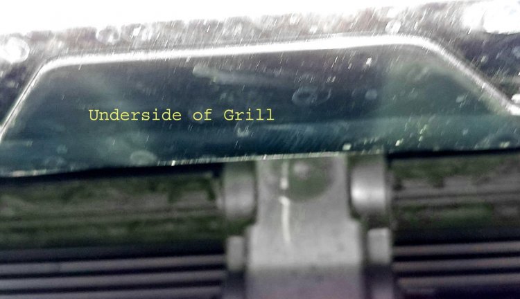

1500367520_A2019-gmc-sierra-1500SLTnocamera.thumb.jpg.deb71d51c595d97e19e73510d2456a4f.jpg1990627450_B2019GMCSierraAT4(1)copy.thumb.jpg.bf8287a1e4c93ad4eac60f40fb24349c.jpg559797917_C2019-GMC-Sierra-Denali-3.thumb.jpg.21e62794542440b726d520477a493575.jpg
Here are better photos depicting the 2019 Sierra SLT, both with and with out the front camera.
You'll note that it is mounted on the grill,  straight in line below the letter M in GMC.
There is a slightly raised mounting pad in the area where the camera gets mounted.
It doesn't appear that a new grill would be required to mount a front camera.
Though I didn't try to move the camera eyeball on the dealer's truck, it appears to be adjustable for angle.
However, reprogramming/flashing or replacing the assembly that drives the LCD screen would have to be done.
