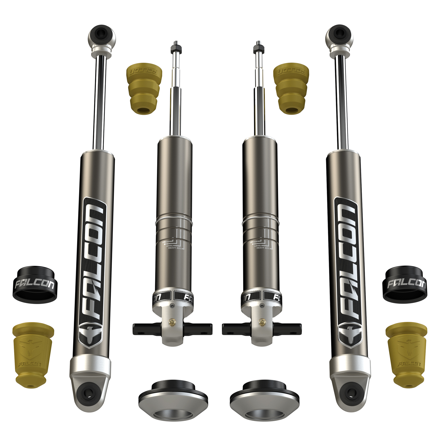

There is also this kit that no one talks about.
Comes as a set of 4 only at about $1300
