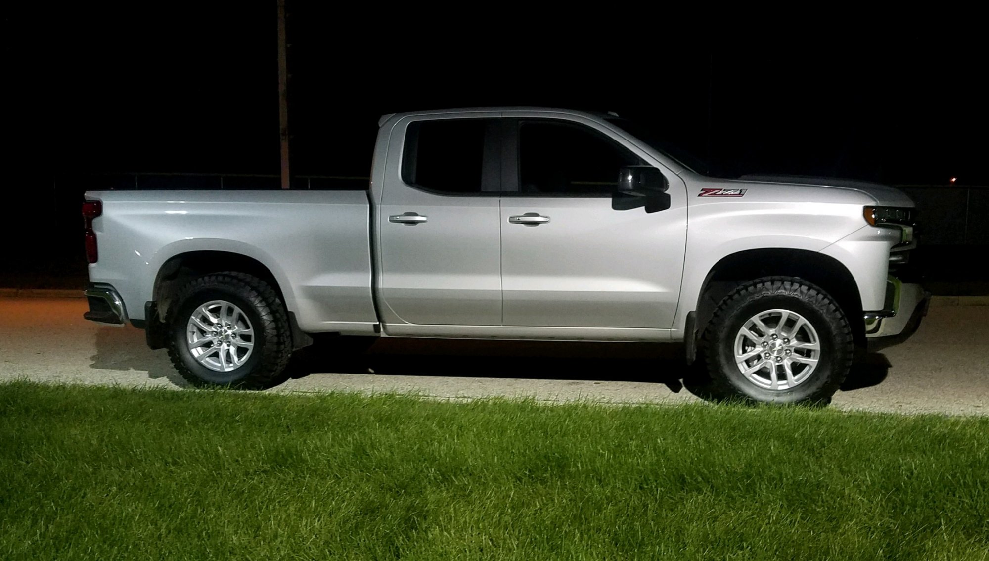

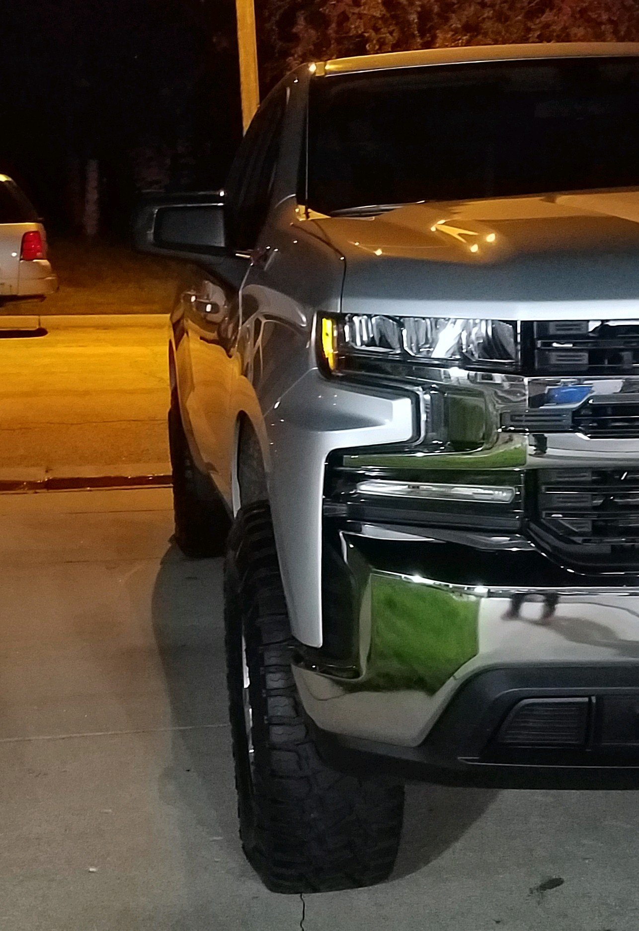

35x12.5's on a 2019 LT Z71
2.5" leveling kit in the front with a 1" spacer for the front wheels. The rear was left stock. I did need to remove a bracket from behind the fender liner along with cutting and forming the mudflap with a heat gun to help with rubbing.

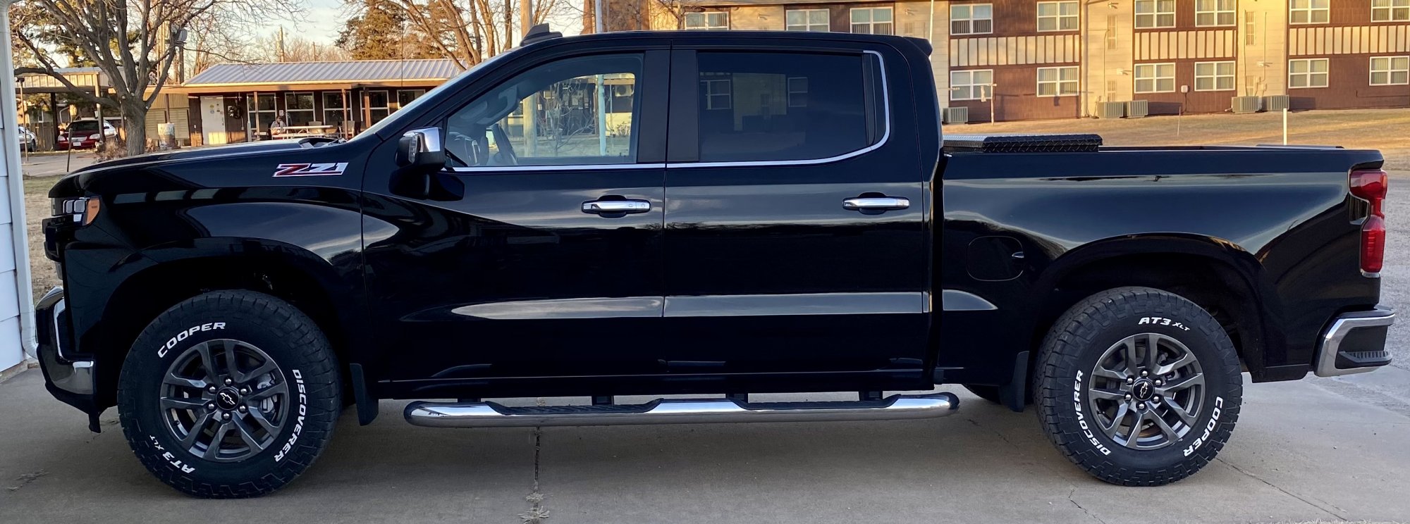

30841731-6F24-4650-B455-F22BA2138D92.thumb.jpeg.463dc568dfdcbfe5810af9ccee4cad69.jpegFor what it's worth, I have Cooper AT3 XLT 275/70/18's (33.2 inches) on my truck (2020 Silverado LT) with no level or lift. There is no rubbing or issues. I am getting a 3" Superlift installed next week but would not need it if I didn't want it.
Edited by RustyVee
  • Thanks 1
That’s a nice looking truck. I have a question about your 18” wheels. Is that the factory finish on those? I have the same 18” wheels on my RST, but they’re the boring plain silver. I like the gunmetal color on yours much better.
4 minutes ago, RustyVee said:
No, I refinished them with a Rust-olem spray paint.
Well, they look great! I’m guessing 3-4 coats plus clear?

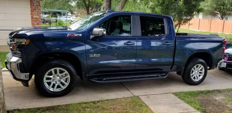

On 6/6/2019 at 10:21 PM, Philipgonzales3 said:
https://www.customwheeloffset.com/wheel-offset-gallery/677758/2019-chevrolet-silverado-1500-venomrex-vr602-stock-stock
Can I run something like above on my truck?  That truck doesn't look like no LT to me.  Not sure if it could be a trail boss or not which would make it 2" taller?
My truck is a 2019 4x4 Z71 LT Texas Edition.  I want a taller tire if possible.
Currently on 265/65R18.  I honestly don't know much about trucks or tires but I like the look from the link above.  I don't mind an 18" wheel but want taller tires I think.
Truck will mostly be driven in the city/highway.  I like an aggressive look but suppose I don't need mud tries.  Probably would be cool but I assume they would handle worse and be louder?
Anyway open to suggestions on how to get a better look.  Should I just plastic dip the wheels and get taller tires or get the full setup above or something in between?
