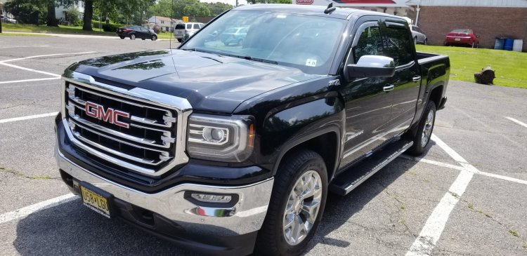

I just took my 2016 Sierra to a professional detailer and he said the black GMC paint is very soft and doesn't know why they use it. That being said I've had the truck for a little longer than a month so I wanted a paint correction, he removed the scratches, swirls and water spots. Then sealed it with a synthetic. He offers ceramic that is good for 3 years but it is not recommended to use a normal car wash, so I went with synthetic since they brine the roads in the winter and use a carwash with an undercarriage cleaning ability. So if you are having questions about your paint it doesn't hurt to see a pro and see what they recommend. I didn't feel confident buffing a black truck, but now I can seal it.

do you use a touchless car wash?
There isn't any around here that washes the undercarriage.
