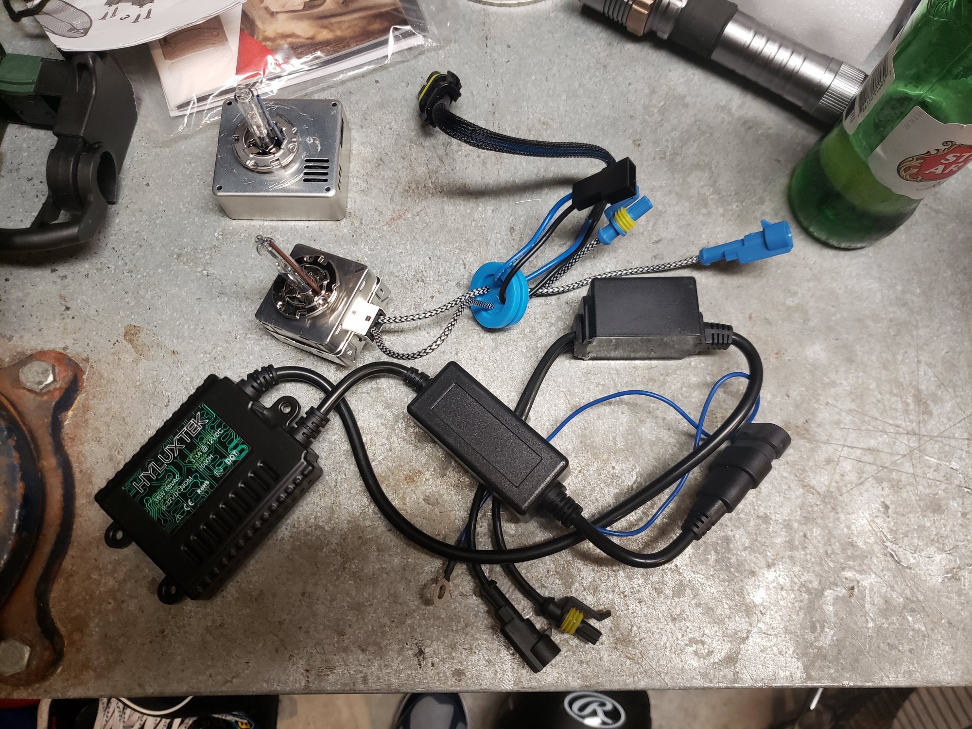

I had the DDM 5000k version of those morimotos, was a definite upgrade over factory, think it was about $200 off Amazon.  Had a few times where one bulb didn't fire, hate that.  Ended up going to this kit: https://www.distantxtremes.com/store/p1164/D5S-Hylux-HID-Upgrade-System.html#/  Got the hylux ballasts, was an easy install.  Lights are ever so slightly more blue at 5500k, but they are brighter and they have a bigger hotspot as compared to the old upgrade bulbs.  Really wanted to upgrade the projectors but after cutting the back of one of my headlights off I realized only way to do it on my 16 is to separate the lens which I'm not wanting to do.  So far two thumbs up on the Hylux kit.  Only beef is when I ordered they were on back order and I didn't know that until after I placed my order.  Took 2 weeks to get but showed up as described.  Pic shows DDM 35w bulb vs the kit.20190802_221016.thumb.jpg.967c833e60156296ab09e3719011214c.jpg
