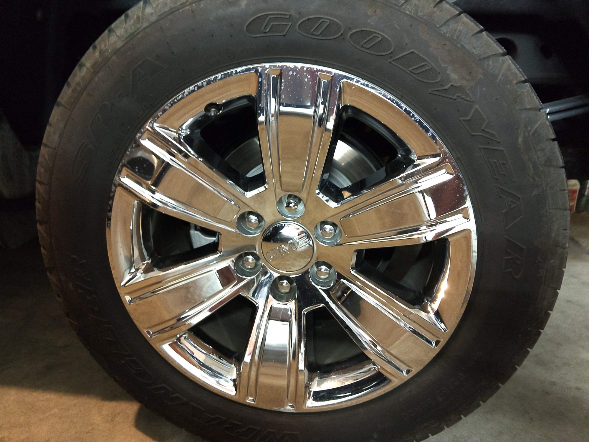

2018 GMC Sierra SLT w/ Z71 package.  The ride to me is fine for now until I take it out on rougher fire roads.  I would like to gain some overall clearance and go with a more aggressive tire.  Mainly a daily driver but will be out on unimproved fire roads from time to time.
Should I keep the 20" wheels I have now and simply go with a more aggressive tire?
Goodyear Wrangler 275/55/20 now, so going with a 275/60/20 would get me into a 33" tire for about $1k.
or
I have a line on a set of 2019 AT4 take off wheels in 18" for +/- $1k.  They come with like new 265/65/18 tires which I would sell and maybe go with 275/70/18?  That would give me a 33.2" tire.  So wheels + new tires = appx $2k
I only have 10k miles on this truck and trying to accomplish this on the best budget I can.  I assume I would need some sort of level kit as well?
Anyone made this change?  Wish they did?  Did it and regretted it?
Thanks!!
(Stock wheel pic attached)

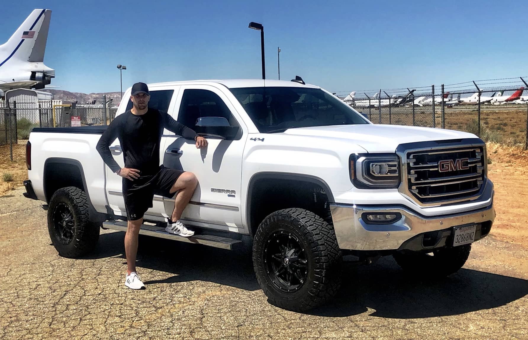

I personally like 18 inch wheels on 33 inch tires for both looks and comfort. To me its a perfect look. I run 275/70/18 tires on +1 offset wheel. Im not sure what the offset is on the wheels your looking at but 33's MAY rub if the offset is to positive or to negative. If you stay around a 0 offset with a level you will clear. I had no rubbing when I had a 2 inch level with that tire size. I did tie back the carpet though with zip ties in the fender wells. I now run a 4 inch bds lift.
Always start with the lift amount. Then read specs on kit. Then pick tires.
But as you say off road the right answer is small rim big tire. It will eat up more bumps and give better ride. You can also air down more if needed.
Good isn't cheap and cheap isn't good.
Buddy just added $4000 king shocks on his lifted f350.
Get some Cooper ATP’s from Discount Tire only place that sells them throw them on the 20’s $800 and you are done, I live on a farm and make 1000 mile trips often wouldn’t drive on anything else.

Thinking the Motofab 2" frt level and the Cooper ATP (or maybe the Falken Wild Peaks) and be done.  $716 on the Coopers and $795 on the Falkens.
I would like to do the 18" AT4 wheels but that will add another $1k and not sure I will really notice (need) that.
