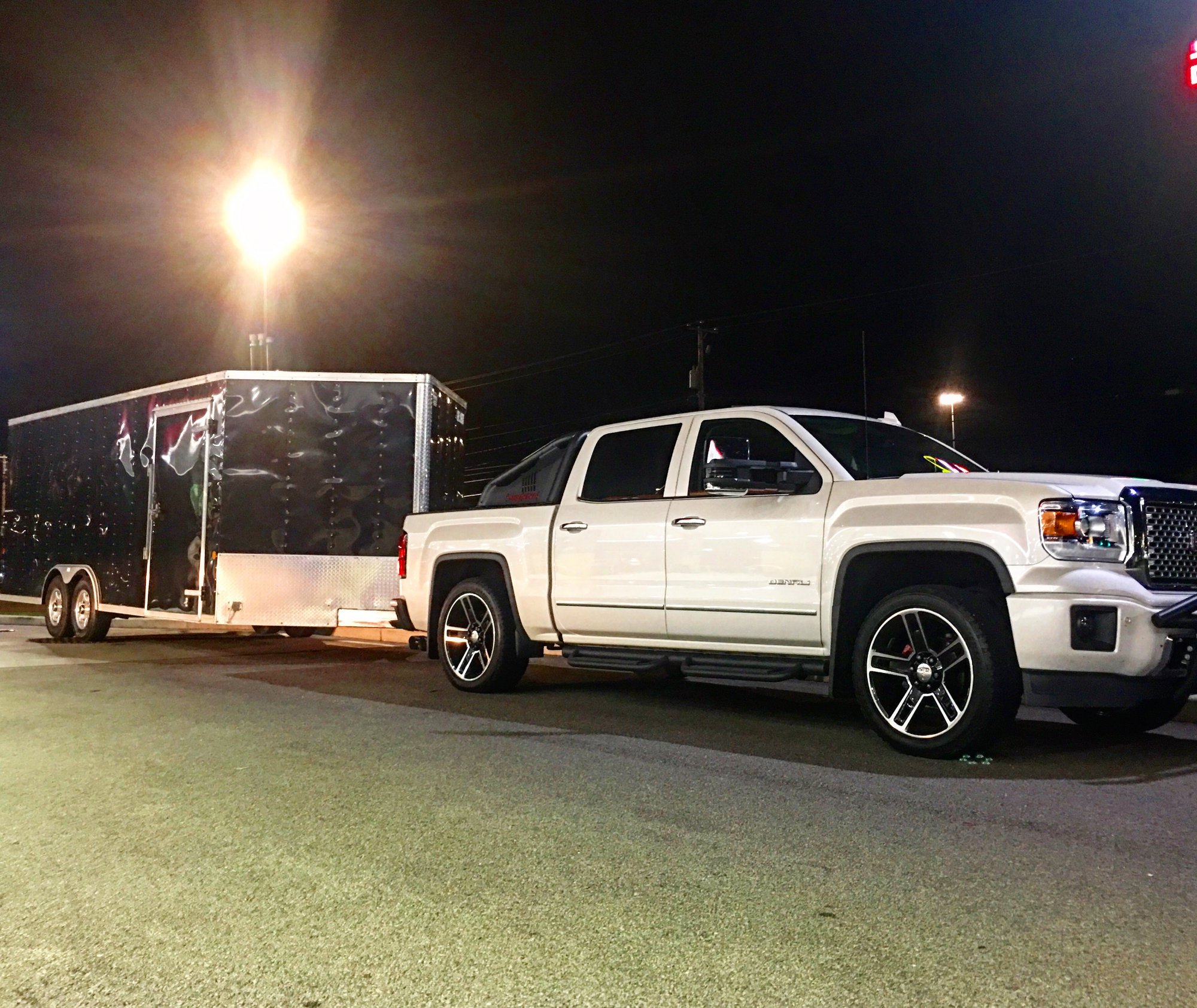

CarMate 20ft with a 4ft Vnose.  Trailer weighs 3750, and 8,000 loaded with my car.  Weight distribution bars should be considered.  I also have Hellwig 61912 Helper Springs installed
