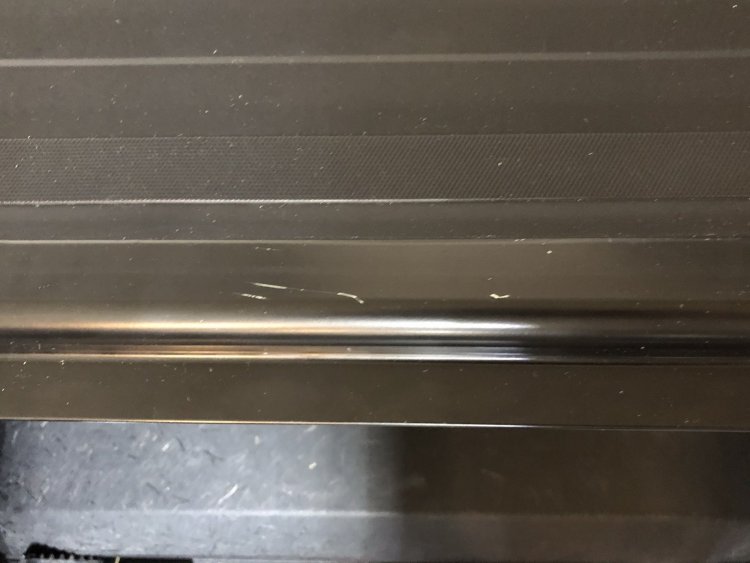

Bought the LOMAX tri-fold hard cover for my 2020 Denali Carbon Pro and can honestly say I don’t like it. It showed up with scratches on the rails, no installation instructions at all, and doesn’t sit flush which will result in serious water leaking issues. Overall, it doesn’t look good when compared to my bakflip fiber-max I had previously on my 2016 F150. It has some very sharp edges that should have been rounded off during production and just seems flimsy. I paid over $900.00 shipped for this crap cover and regret buying it. I really hope decked produces a system for the carbon pro trucks, that’s really what I wanted and can honestly say I regret buying this carbon pro edition due to the limited bed accessories that are, and will be, available.
WOW....I almost pulled the trigger on that till I saw the clamp option so I hope the Rolver works out better.  I'm with you on the Decked system.  Been bugging them to come out with one on their IG page.  LOL
