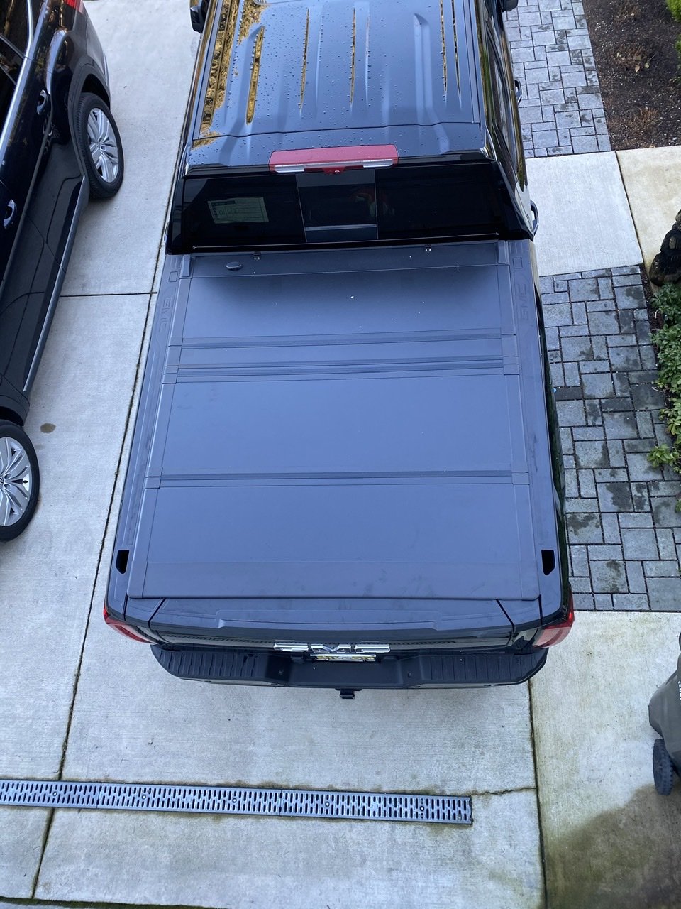

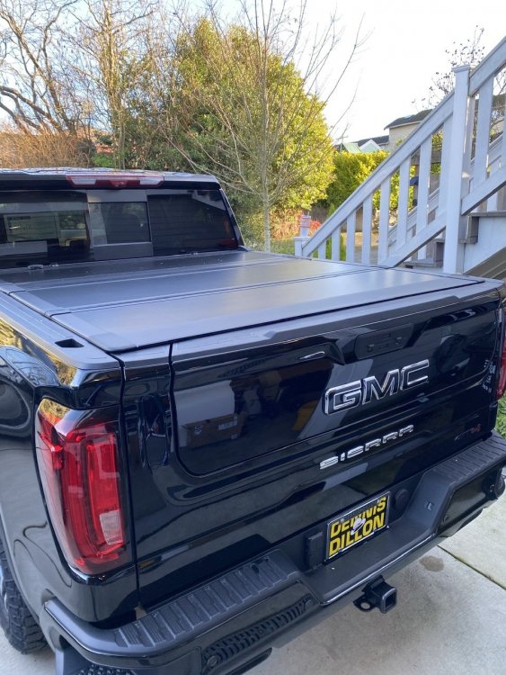

Got it installed today.  Went pretty smoothly.  The passenger side bed cap was riding up a little  so make sure to check for that and press down on the cap before you drill.  One hole I had to oval out a bit because the cap riding up caused the drilled hole to be a little low.
I didn’t have a 7mm or 9/32” bit so I used a 1/4” and it worked just fine.
I highly recommend using a torque wrench to tighten the bolts to 8.7NM (77 in-lbs). The way the rail attaches, it feels like you can keep going a bit more when the wrench clicks, so it’s hard to do by feel.  Also re-check torque if fasteners after you torque the last one.
I noticed a light gap at each corner up by the cab.  Some adhesive-backed silicone foam tape or the like Should fix that if water tightness is important.  Same goes for the space between the two portions of the multi-pro.
Tighten the securing bolts evenly.   The manual says this, and it is important to ensure the tonneau is alighted well so that the slam latches all work properly.

I just bought and installed one of the GMC trifold hard tonneau covers on my 2020 AT4 Carbon bed.  I'm embarrassed to say it took me 2+ hours to install.  I think the French version of the instructions was clearer than the English.
I did lose 2 J clamps inside the frame of the bed and I missed a clamp on each side with drill hole, so mine only has 4 bolts each side...
Its heavy and clunky and it will NEVER get taken off, it's just too difficult, so I hope the wife doesn't buy something big to bring home.
Not impressed but it was the only option out there...

I don't think it's any heavier than a comparable tri-fold from Bakflip or Undercover, etc., but yes it is bulky and heavy.  They warn you it's a two person job, but being myself, I took that as a challenge to do it solo.
Also, from my unboxing experience, the cover was awkwardly folded inside the box with a bunch of styrofoam, so it WILL be easier to fold and remove/install in the future versus the first time.
