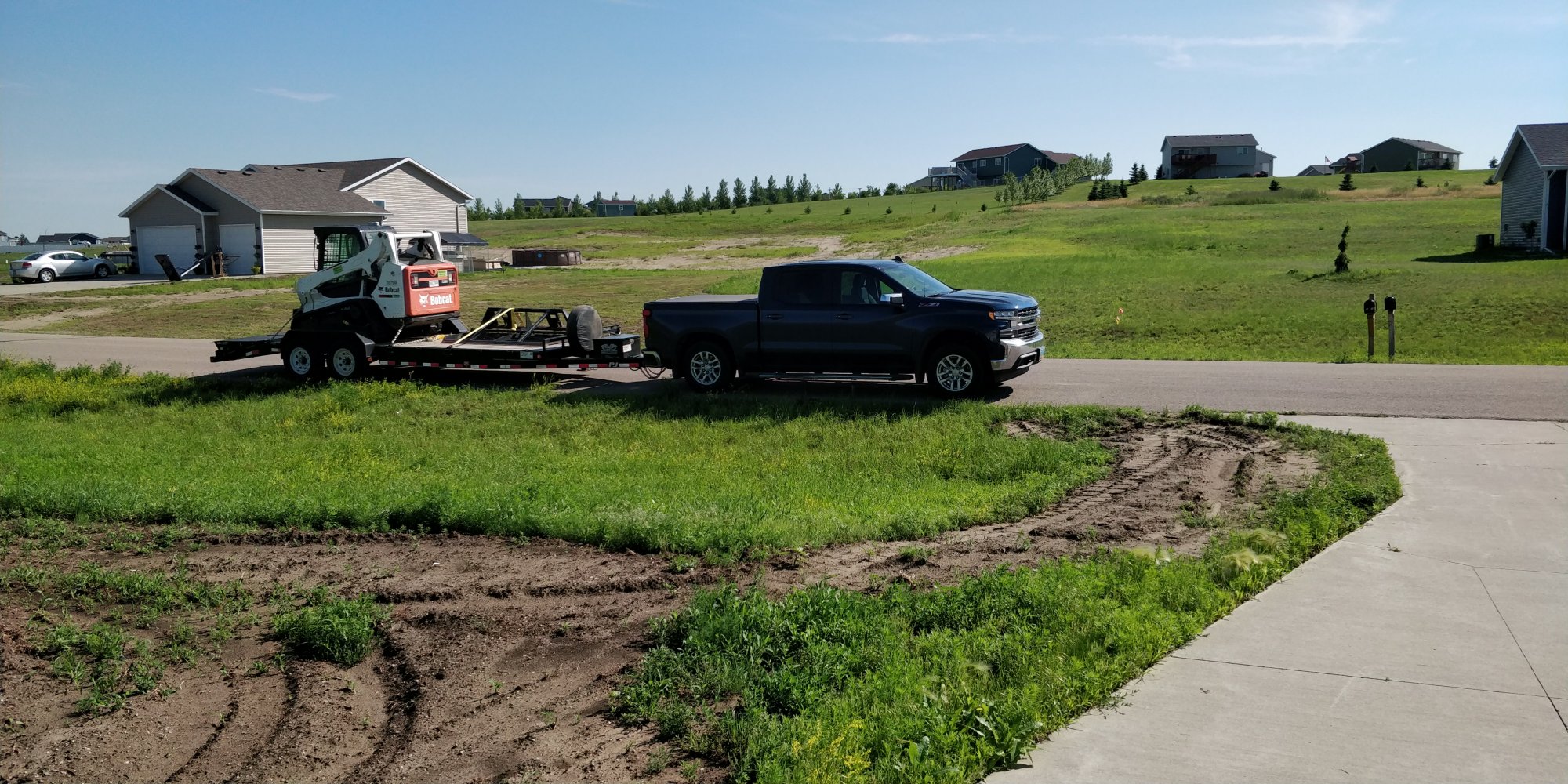

the first picture was my first tow with this truck - I use to put it a little further back with my 13 F-150.
IMG_20190525_133644.thumb.jpg.b1623705085d2b0abdf7791cc697327c.jpgIMG_20190705_112631.thumb.jpg.dc4fd1397aaeb791c6ecaf134c7b56f8.jpgIMG_20190711_172134.thumb.jpg.fd2d8470e155cc1e44a80b1e0631ca21.jpg
