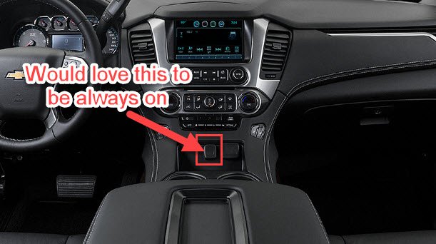

Hi All.
Wondering if there was a definite answer on this - Can someone provide pics?
What do I do...Move what fuse from where to where?  Which fusebox?
Specifics - doesn't seem to be 100% sure direct and clear advice on this one.
I want constant power on my 12 volt cig lighter in the front center console.
I appreciate the help and thank you in advance
